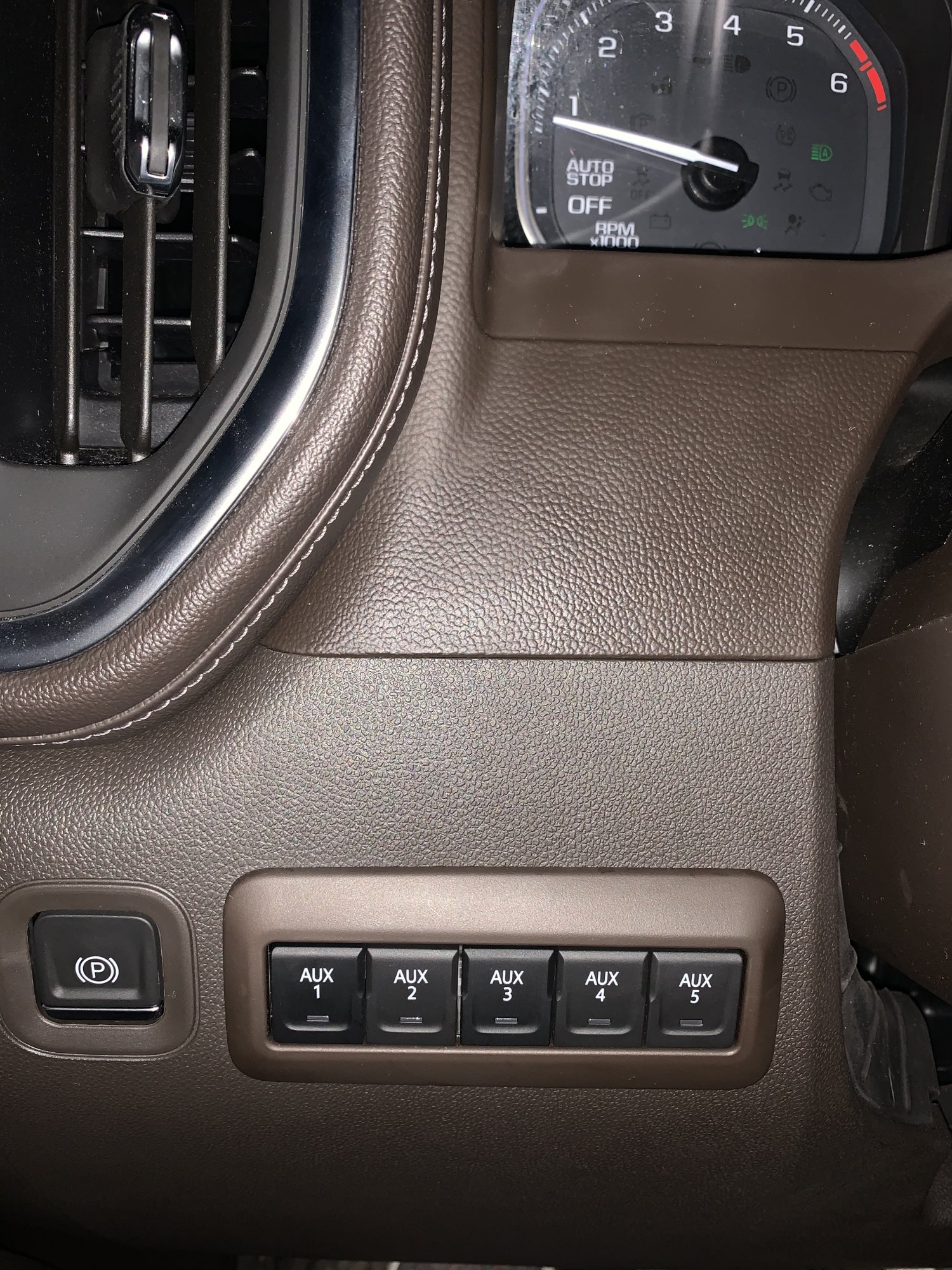

Aux switches are on the left of the steering wheel in this generation of trucks!

I don't have that bank at all.  Did you add that in?

Yes, I believe it can be factory ordered as part of the snow plow prep package. But easy to add after the fact as well. Few threads on here about it. Here’s one!
