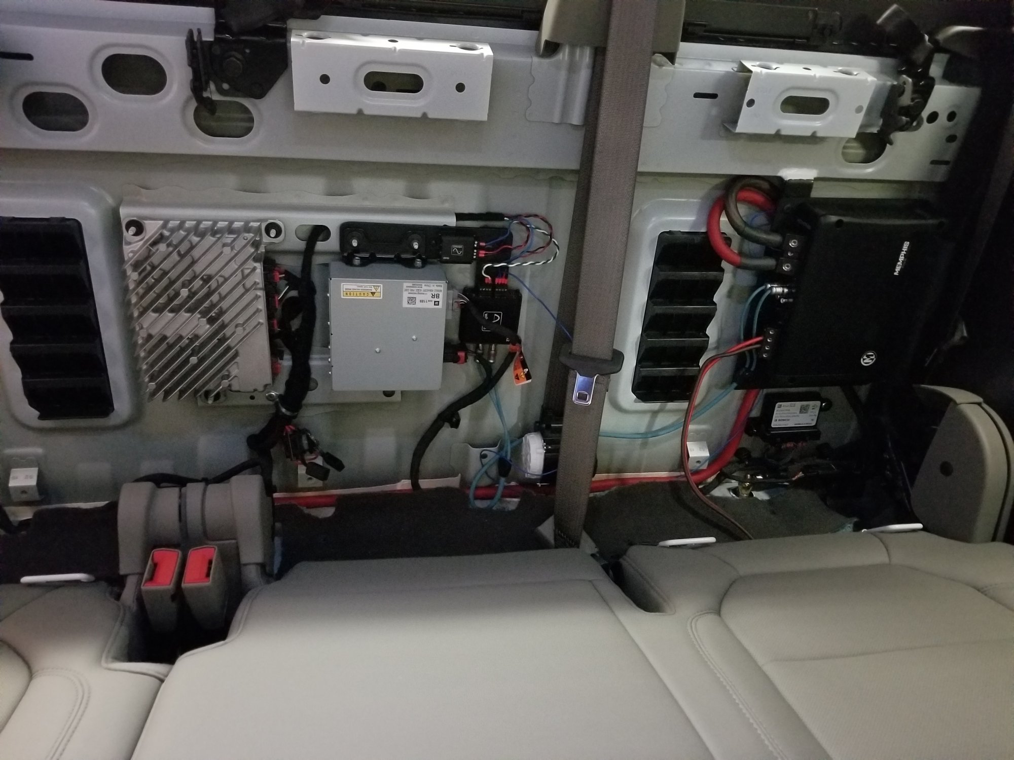

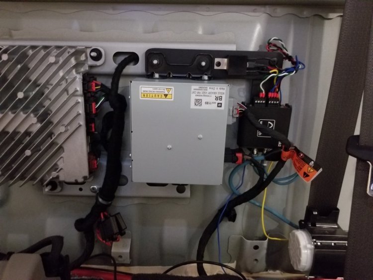

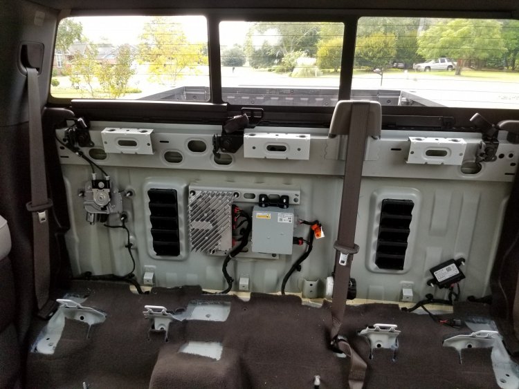

I have almost finished my system upgrade and found that the Bose amp on my 2019 GMC Sierra is located behind the back seat next to my truck's power inverter.
Removing the back seat is a learning experience since it doesn't fold down.

It has been the longest install to date.  I have encountered problems like shearing off 2 ground lug bolts.  My amp kit did not include enough power or ground wire.  I used the wavetech link 2 line converter and could not maintain power to it, so I had to add a Irad programmable voltage variance turn on switch to keep power going to my line converter, thus supplying a remote turn on switch for amp.
My amp and subs are a bit much for this upgrade.  The subs hit way too hard and after adjusting for clipping, I have my gain on amp set incredibly low.
Tomorrow is another day and I think I can reach my final goal with some meticulous tweaking.
I have included a few pictures of the build for reference.
Okay, the install is complete.  The IRAD by Wavetech is really cool, but like other line converters had problem cutting off due to drops in voltage.
I ended up taking out the IRAD and having a relay tied into my BCM in order to maintain a constant power source when my vehicle was switched on.
The other Bose speakers really struggle to keep up with the 500w rms JL subs.
Overall,  my upgrade was a success.  I am happy.
