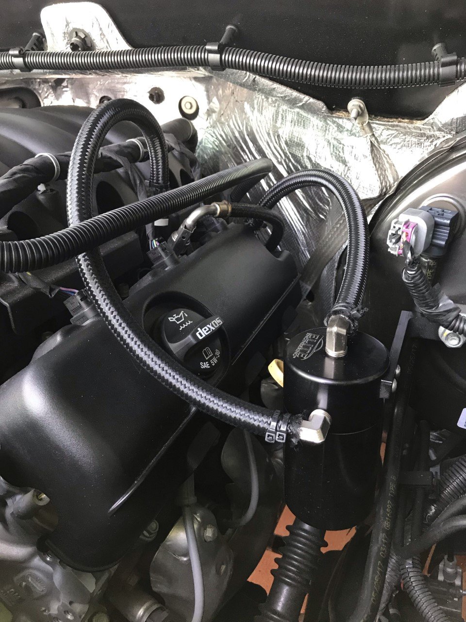

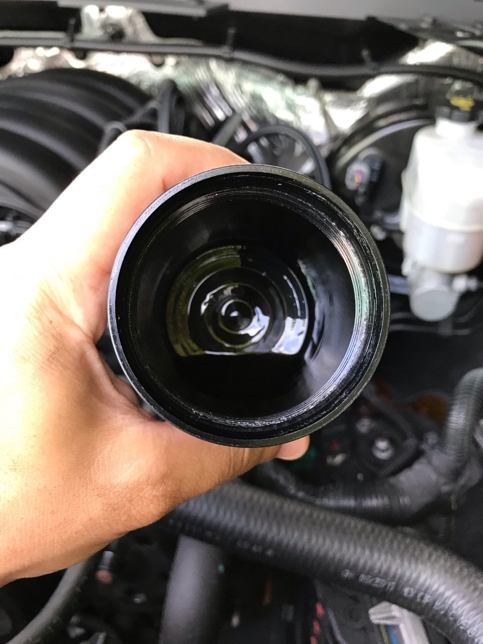

I occasionally see guys ask about catch cans for the 4.3 so I am putting this out there hoping they will run across this in the future.Currently there is no catch can directly for this application however for DIYers like myself the Elite can kit for the 5.3 V8 in the Silverado will also work.You would just need to purchase some 3/8" hose and a few 3/8" hose clamps.A catch can is probably not absolutely needed in this application but for the OCD guys who occasionally ask the information is now out there for you. dasda.thumb.jpg.bf32c1491f5c5dc16294a4ab7708c98f.jpgadad.thumb.jpg.01cfd251db0bdb373707427afcab8f67.jpgadsa.thumb.jpg.93f7cf6ec481ef42c2f497647cbf6f32.jpg

Couldnt agree more.Also one could theoretically use any can but the universal chinese cans wont have baffling inside to trap nearly as much oil.You would be looking to spend $100+ for a well made one from a known vendor like UPR or Elite.Additionally the ones intended for the 5.3 will come with a bracket intended for fitment on the Silverado so there is no need to fabricate one.The main difference installing on the 4.3 is the pcv ports will be in different locations from that of the 5.3 but its a bolt on deal for the most part

Definitely easier and both ports are on the same side of the motor.I am thinking the intake manifold itself must have a check valve built into it because the line itself didnt when I cut it open to reuse the factory quick connects.If I had to do it again I would probably use a can from UPR.Its much cheaper and looked just as well built if not better than the Elite when I installed one on my other vehicle.

No. The line on the passenger side is the fresh air inlet from the air box to the rocker cover.
There is a PCV valve at the back of the drivers side head with a hose that goes to the drivers side center of the inlet manifold. There is no orifice. The can is placed between the PCV valve and the manifold. Couldn't be more straight forward.
