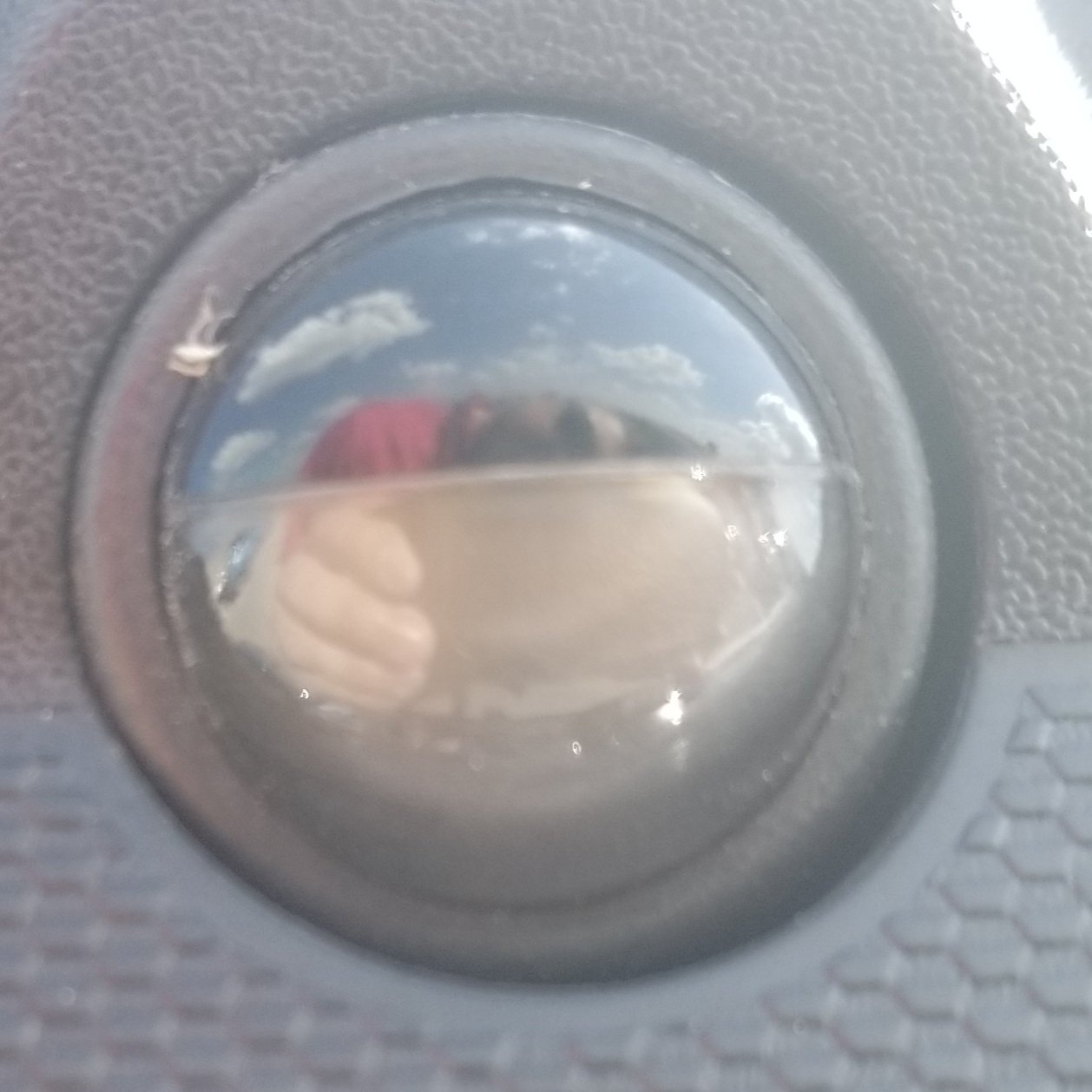

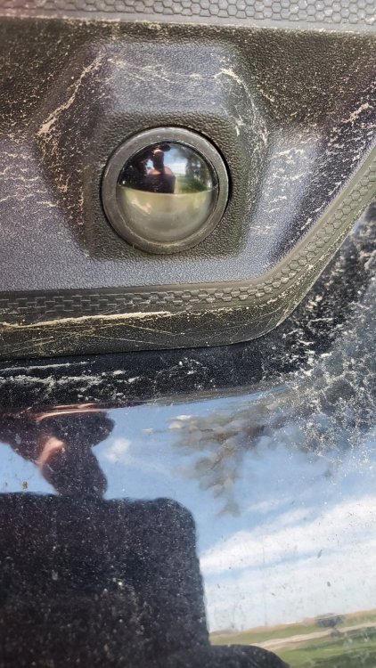

Is anyone else having an issue with condensation inside the camera on the tailgate?  It's the one on the right that is the rounded fisheye.  I'm going to take it in for warranty but wanted to see if anyone else was having this problem.
The dealer told me the lense was supposed to be hazy and it wasn't condensation.  They told me they went and looked at another truck and it was the same and it's designed like that.  Any thoughts on this?  Not sure if you can tell from this picture or not.
its Hazy because IT'S NOT a CAMERA! its an LED light that lights up your hitch ball when you view the hitch view camera. the camera lives to the left on the release pad
