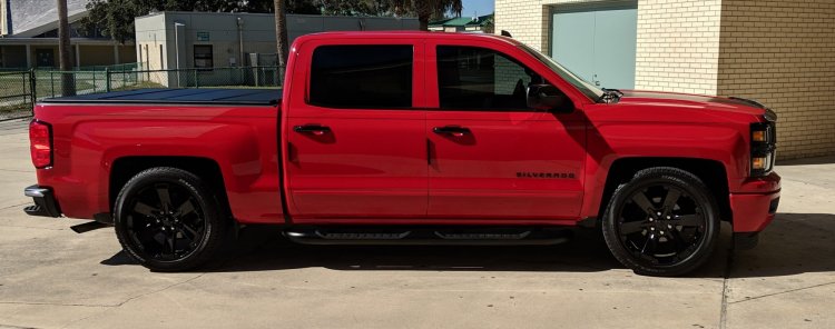

Went 2-4 drop on my 2wd.  I love the look.  1SLOW1500 has the right of it.  McG or Belltech.  I have Belltech drop spindles on the front and flip kit on the rear on 22" rims.
