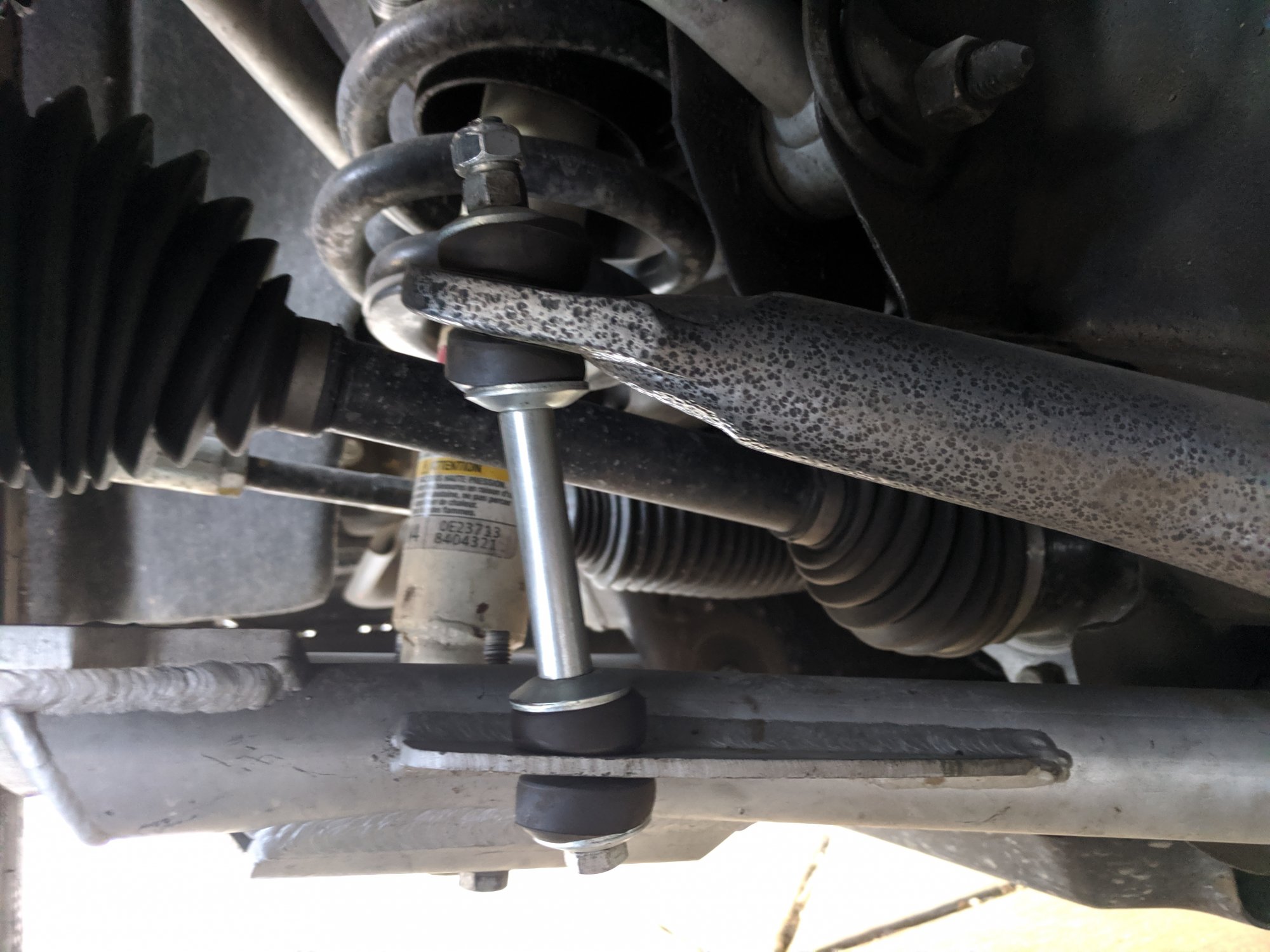

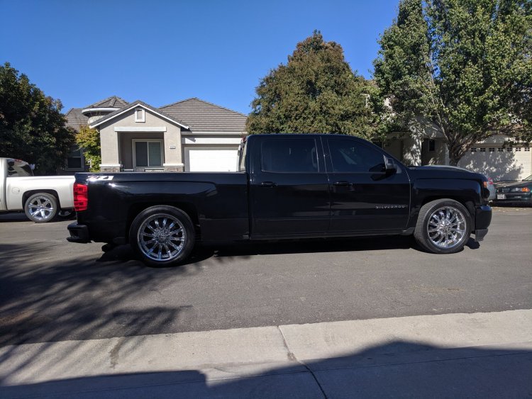

I bought mine with it already dropped IHC, inez 4/6 it's ok I guess, slight steering radius loss, I'm working on tightening it up put on a Hellwig front sway bar but having a little issue with the end links lining up right (they are at an angle), Hellwig sent me some adjustable D bushing brackets and I bought some heavy duty Mevotech end link bushings I am hoping that just getting the sway bar moved back an inch or so will line the end links up if not I may have to have some brackets made or drill a new hole in the lower control arms, making the sleeve shorter on the endlink just makes a worse angle.

Had to tell just from pics but you can do rod end links, drill hole in arm or even build a reinforced bracket that bolts to the a arm and moves it anywhere you like.

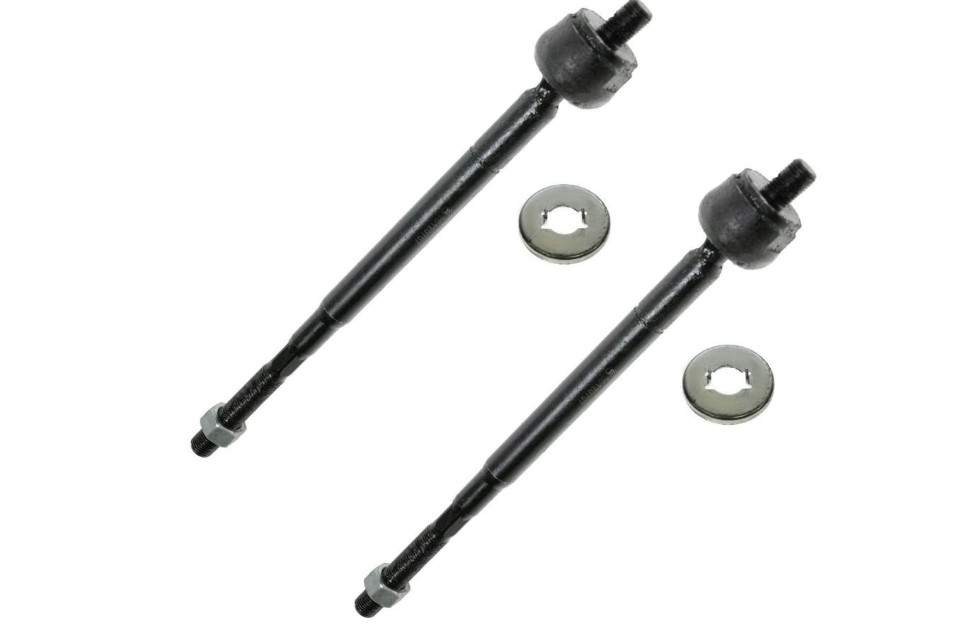

not quite sure I follow what you mean I see rod ends but those are at the opposite angle of what I need, do you mean something like this? I see these for lift kits but it would have to be machined down much shorter
It is used on race cars it is a all metal swivel end. That way with a 90* bracket bolted to the a-arm that point can swivel. Or billet off set sway bar mounts are available but honestly you.can make them up cheap. Nothing but bar stock, drill press, and a tap.
There are companies that sell the brackets to swap from horizontal to vertical then rod ends just bolt though. Only issue is it rides harder then poly or rubber bushings.
