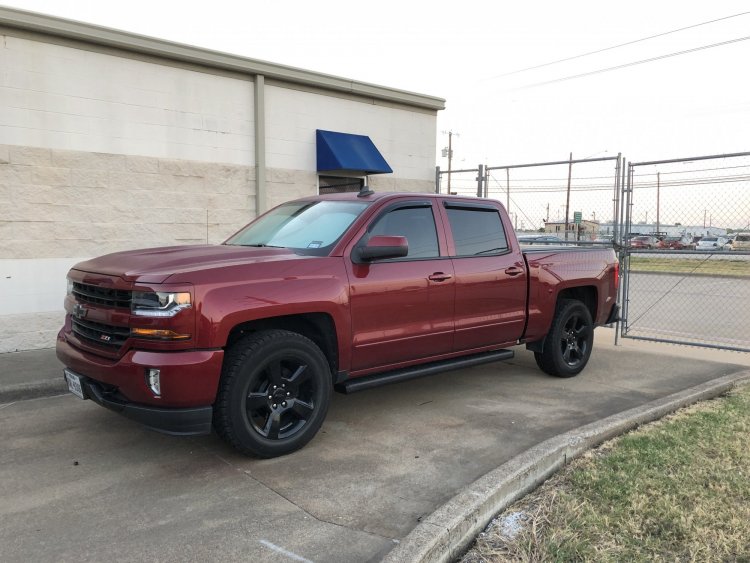

1 hour ago, rah7777777 said:
Not the best pic at all, but I lowered my rear about 2" to help level it out. Still a little higher in the rear, but much better than stock.
Looks good, what did you use to bring down the rear?
It was a lowering shackle.
2” I think, or right around that. Easy install except dropping the hitch receiver and bending the pinch weld on the bed up to get the bolt to clear.
