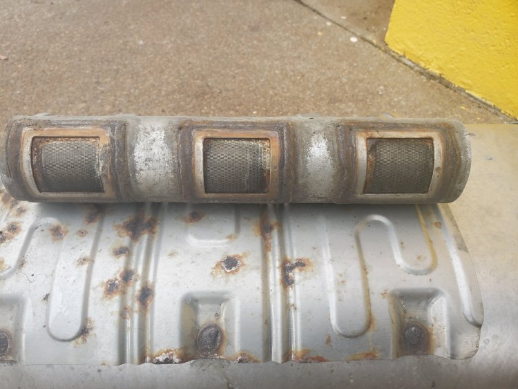

SquireSCA Posted December 14, 2019 Posted December 14, 2019 I have a new Trail Boss 5.3L and cut out the muffler and the flapper valve and had a muffler shop weld in a pipe in their place. Sounds great. There is no resonator, just the mesh things which I can't figure out how they work or what they do. It sounds awesome and no drone on the interstate so far.
19AT4 Posted December 28, 2019 Posted December 28, 2019 From what I've seen it's tough to get lots of sound out of these new trucks, I swapped a Carven TR series in (Moderate sound level muffler) and it was extremely quiet. I taped over the rear mesh screens and it helped quite a bit, there's 3 mesh screens at the end of each tail pipe. My guess is that it just disperses the exhaust in sections to help quiet it down since there's no restriction within the pipes. But it drones bad from 100-110km. A friend of mine (Same truck, 5.3 with the 8 speed) put the carven R series in (Race muffler) and it sounds 100x better than mine but it drones terrible as well. Magnaflow is definitely on the quiet side but it's worth trying to see if you like it. It'll give you a low tone/rumble, especially if you leave the rear mesh screens alone. If you have the $ look into corsa. I've ran every muffler under the sun on my gas trucks and its the only muffler that has ZERO drone, it sounds completely stock on the highway. But just as loud if not louder than any race muffler from the outside, there's a lot of design and technology in that muffler. For the flappers I'd get them cut out, you can pin them open if you want but I don't think they have much effect on the sound level. If you do a muffler swap and leave the mesh screens alone along with the flapper it'll sound 100% stock in cab.

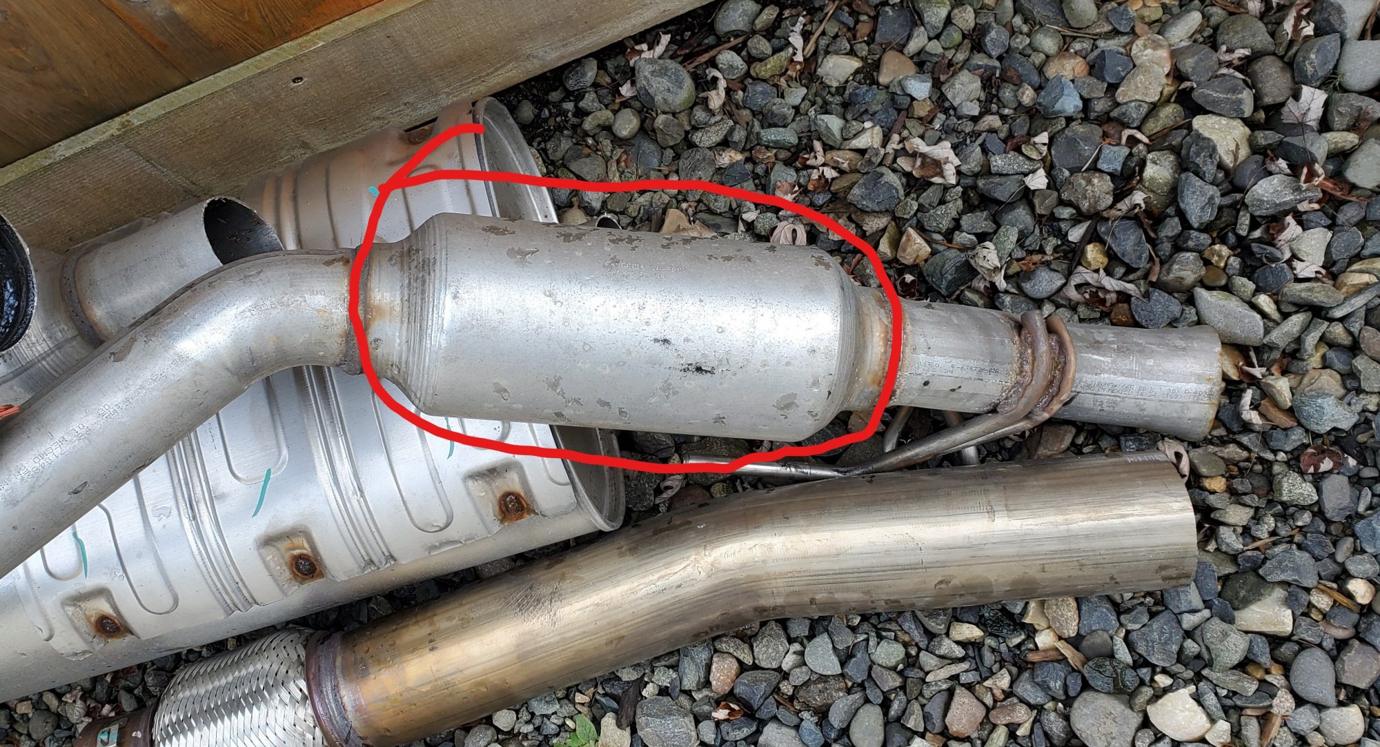

Londart2020 Posted December 28, 2019 Posted December 28, 2019 20 minutes ago, michael betz said: Cut out flapper , muffler , and those stupid resonator screens and replaced with stainless steel and borla atak. What on earth is that thing? I thought the "screen" people were talking about were right before the piping goes into the bumper?? like this...
Jay P Posted December 29, 2019 Posted December 29, 2019 Those screen things are only on the 5.3l. The 6.2l has real resonators. Jay
Londart2020 Posted December 29, 2019 Posted December 29, 2019 3 minutes ago, Jay P said: Those screen things are only on the 5.3l. The 6.2l has real resonators. Jay Copy
Londart2020 Posted December 29, 2019 Posted December 29, 2019 1 hour ago, Jay P said: Those screen things are only on the 5.3l. The 6.2l has real resonators. Jay So since I do have the 6.2l, chances are if I do have those reattached 90-99% of the drone I do have should go away right??
SquireSCA Posted December 29, 2019 Posted December 29, 2019 Those screen resonators, as silly as they look, actually work.
Londart2020 Posted December 29, 2019 Posted December 29, 2019 1 hour ago, SquireSCA said: Those screen resonators, as silly as they look, actually work. So what your saying, is if I get these put back on there is a good chance the 40-50 MPH "helicopter" sound will all but go away?
SquireSCA Posted December 29, 2019 Posted December 29, 2019 Well, I have the 5.3 and it doesn't have resonator chambers like your pic shows... Mine has those square screens welded into the sides of the pipes... I get droning when I cover them. I don't get a helicopter sound because my motor has DFM rather than AFM...
