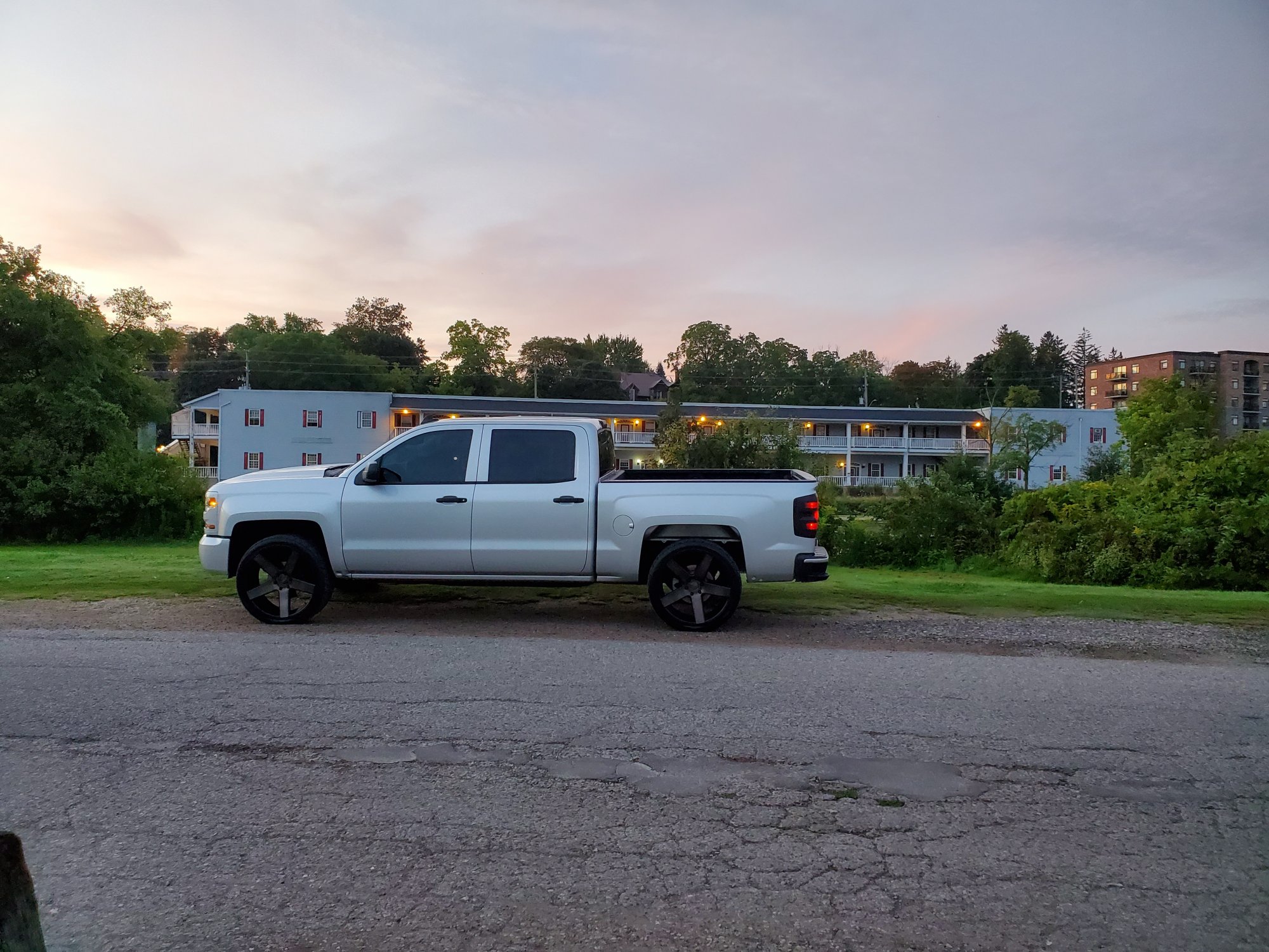

hey guys I got a 2018 silverado 1500 with a 5.3 I want to make this all motor
I've heard of diamond pistons brian tooley kits turbos camshafts ect and bigger intakes more gas bigger injectors fuel pumps
but what else and where can I purchase these.  I need to know some trusted brands ill be updating exhaust and intake to eventually

Hey Buddy,
Nice truck! Looks super clean. Take all the comments with a grain of salt.
So straight NA! I like it. So you're going to need a few things. Top end and bottom end upgrades.
TOP END:
I'd start with a Ported Cylinder head/camshaft package W/ AFM,DOD Delete.
https://www.texas-speed.com/p-5783-tsp-cnc-ported-gen-5-53l-l83-heads-camshaft-package-outright.aspx
https://www.texas-speed.com/p-5443-texas-speed-performance-gen-5-lt1-lt4-l83-l86-dod-delete-kit.aspx
Get yourself a BIG intake manifold and throttle body.
https://gwatneyperformance.com/product/msd-atomic-airforce-lt1-intake-manifold-2700/. (get ported if you can afford the extra cash)
https://gwatneyperformance.com/product/katech-103mm-throttle-body-gen-5-lt1-lt4-lt5/
CAI
https://afepower.com/afe-power-54-74104-momentum-gt-pro-5r-cold-air-intake-system
BOTTOM END:
If you're seeking more than 600 wheel you will need to beef up the rods/pistons/bearings.
https://gwatneyperformance.com/product/gpi-complete-gen-5-l83-5-3l-drop-in-piston-connecting-rod-package-14-19-silverado-sierra-tahoe-yukon/#configuration
FUEL:
High side fuel pump, middle fuel pipe and injectors.
https://goturbo.net/arm-high-pressure-armageddon-high-pressure-fuel-system-upgrade
Low Side pump if you can stomach the cost.
https://goturbo.net/arm-465fp-ext-armageddon-465lph-lift-pump-2014-2018-extended-double-cab-chevy-silverado-gmc-sierra
Meth Kit to get you over the hump.
https://www.rallysportdirect.com/part/water-and-meth-injection-kits/310-brd-snow-performance-stage-3-boost-cooler-efi-2d-map-progressive-water-methanol-injection-kit?gclid=EAIaIQobChMI8_bvydne5gIVTP_jBx34ogrGEAQYAyABEgKBJfD_BwE
EXHAUST:
If you live in a state with emissions testing.
https://afepower.com/afe-power-48-44003-twisted-steel-headers
If you're not in a state that requires emission:
http://arh.lmperformance.com/shop.asp?brand=american-racing-headers&gclid=EAIaIQobChMIn4Kdmdre5gIVx8DACh1-OwkhEAAYASAAEgL-v_D_BwE
This should get you started. OH, you could always just get a Whipple with a tune and get 560 wheel on your own for $6.5K The former list will cost you 15k+ parts maybe $17k parts/labor.
Happy trails.
