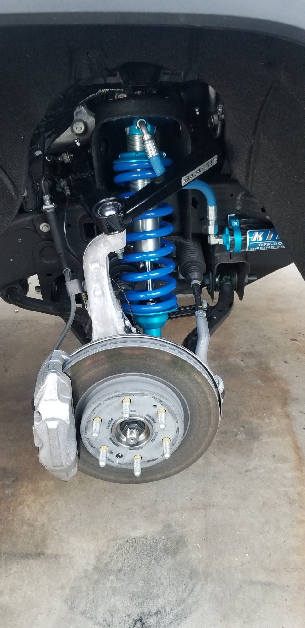

King herecwith bajakits UCA. Really happy with the ride
very nice!....proper setup there....if your gonna spend the money than spend it wisely
Thank you. Agreed

whats lift setup?....did you go thru brenthal bros (baja kits) and did they have it in stock?
I went to king and had them turn the coilover 2.5 turns for a total of 12.5. It sits about 3.5" taller then a stock x31.called JT
Yes they had them in stock. If you have any question feel free to ask.

thanks, just about ready to do mine and this is direction I am headed....

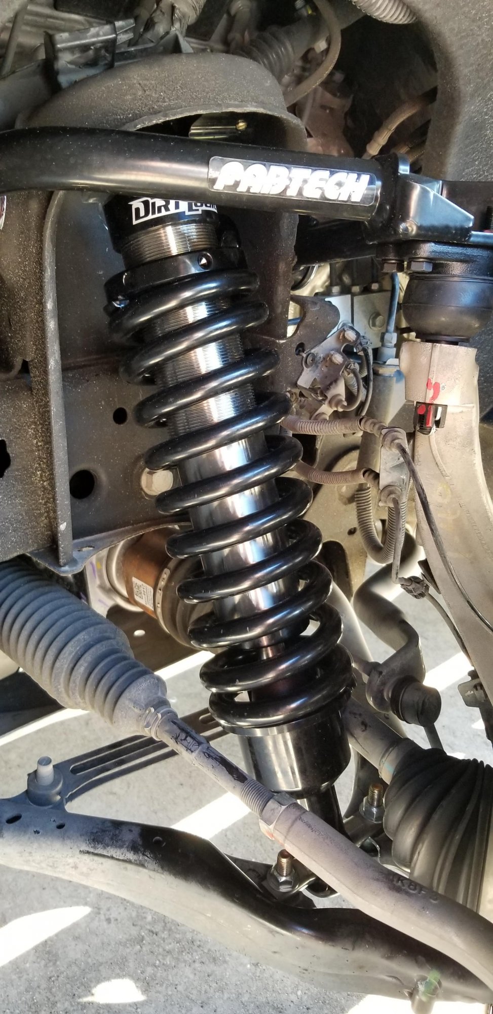

On 1/2/2020 at 2:22 PM, KillerOfMillers said:
FabTech DirtLogics.  1.5" over stock AT4
How do you like them so far? Have been thinking about getting this setup. How are they on the road compared to stock?
