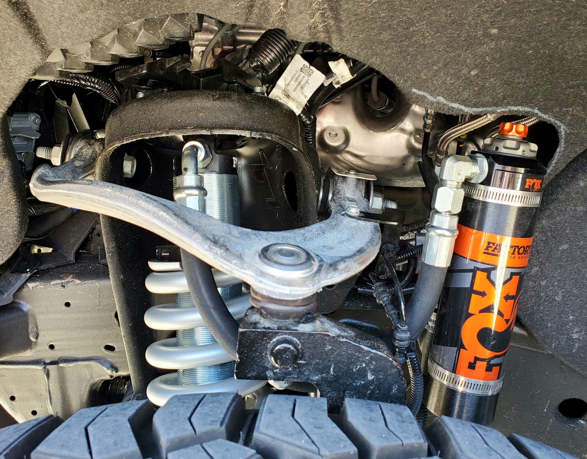

I went to king and had them turn the coilover 2.5 turns for a total of 12.5. It sits about 3.5" taller then a stock x31.called JT

2.5 turns for total of 12.5?......so you have AT4 and it sits 1.5 taller than stock 2 in lift that came with it?....
No. I have a X31 but I'm 3.5" taller than stock. so 1.5" than an AT4

Sorry for the delayed reply.... I have them installed on a stock AT4, these added 1.5 of lift to the front and I kept the rear stock height just swapped out shocks.  The ride is definitely better, it doesn't feel like riding around on marshmallow suspension anymore.   The ride firmed up and had less body roll.  This was running 22x10 on 33x12.50x22, ride wasn't rough but a little firm.  Just recently swapped to 18x9 and 295x70x18,  the ride was a little softer due do more side wall but the planted feel of the truck remained.

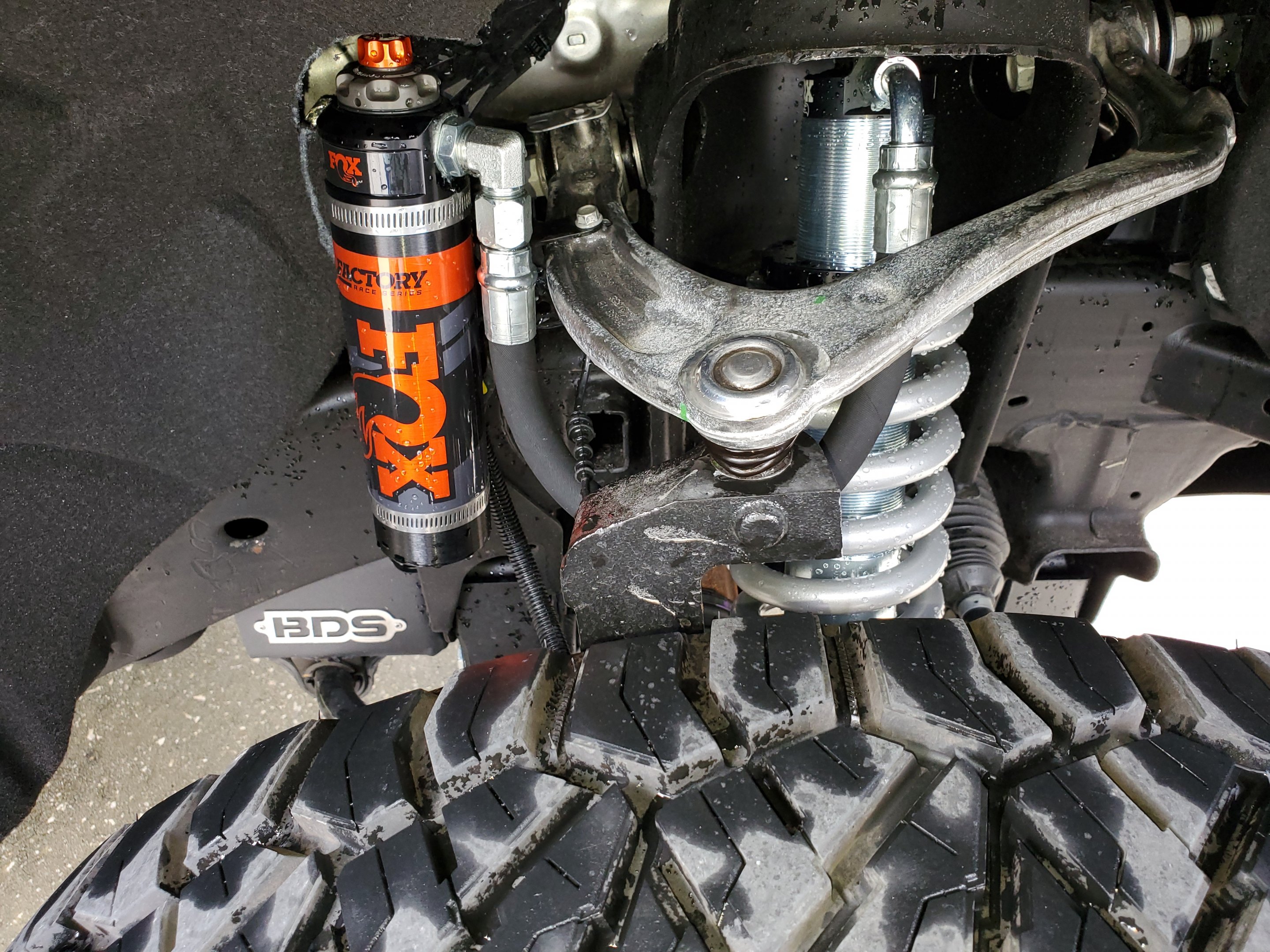

Just installed...so far so good.20200110_140824.thumb.jpg.69c04c737828409021aee1670c39fb24.jpg
I don't see the coilovers listed on Fox's website for the 2019s. Whats the part numbers you received and where did you get them? Have any other pictures of your setup? Sorry for the bombardment of questions.
