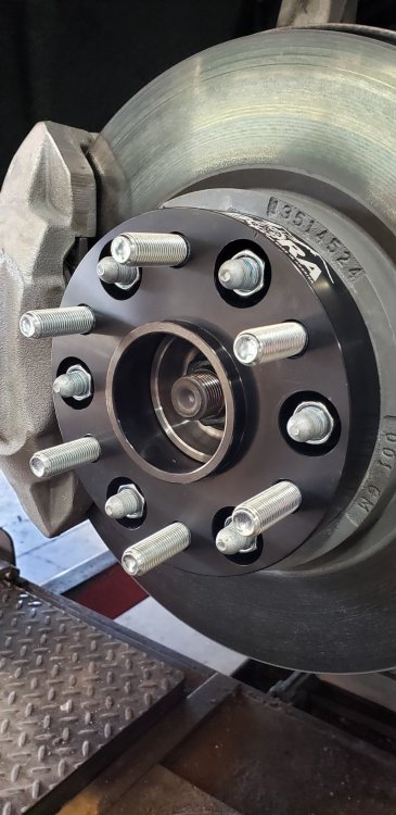

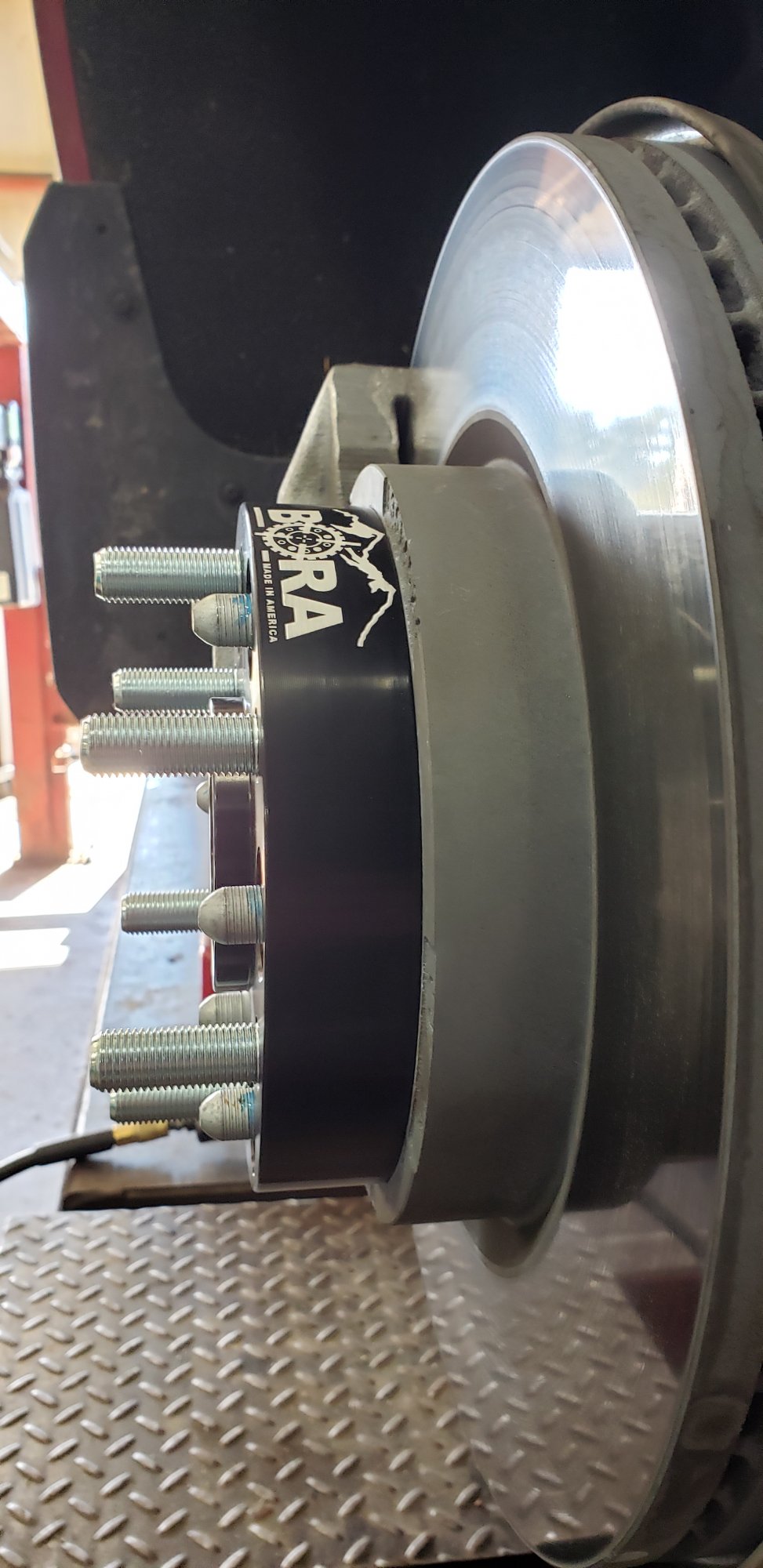

I just got some BORA spacers on today.... They're the most popular brand on the forums for our silverados.  Made n USA, top quality.
If you just want hub centric spacers, you can get their 3/8" spacers, which will use the stock lugs and bolts.  Otherwise, you have to go up to a 1.5" spacer, or you'll have to grind off the extra stock lug bolts sticking out.  The Trail Boss wheels have pockets on the back side of the wheels that are able to fit 1.25" wide spacers, and require no trimming of the stock bolts... which is the size I got.  Not sure if this size will work on other stock wheels or not... have to see if there's room on the back side of the wheel for the stock lugs protruding out to fit in.
So to answer your question, with BORA spacers you can more or less go with .25" or .375" spacers with stock lugs or jump up to 1.5" (maybe 1.25" depending on wheel), without having to trim the lug bolts.
Here are some pics:
20200103_132938.thumb.jpg.ae858547f425f59325a358c044b60238.jpg20200103_132944.thumb.jpg.bcd28aa571cf40972ef9c0edf7cdd13b.jpg
20200103_171435.thumb.jpg.0d7bed5abbd802fb4fae21b163ea6f96.jpg20200103_171500.thumb.jpg.a370a9fe9f32961cdc2e42a912c6c37a.jpg

Cool.  I have LTZ with 4" so I should be good too.  How much stud sticks out past spacer?
Didn't measure, guess I should have... If you look at the pic, doesn't look like more than 1/2".  They fit in pocket on back of TB wheels no problem though.

After thinking about it for a minute... They can't be much more than .25" outside the spacers, because 1.5" spacers will fit ALL the stock Chevy wheels without any cutting, and the ones I got are 1.25" spacers, so math suggest they aren't sticking out much more than a 1/4 inch.

1.5" will bring the tires out for sure.  Not sure what you mean about using the stock lugs.... If you go over 3/8" wide spacer, you'll be bolting the spacer to the stock lug bolts, and then the wheels to the spacers with the stock lug nuts, as pictured above.
