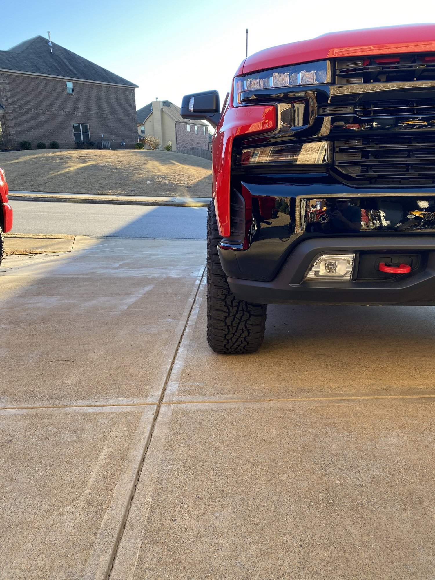

@Swiftks do you have any more photos of your truck with the spacers installed. Something zoomed a little further back that shows the overall stance?  This is the exact set up I was thinking about doing. Thanks a ton in advance.
Here's a pic zoomed out, best I can get it.... the perception can really change depending on the angle you're taking the picture from.  For reference I was standing right above the middle line in my driveway.

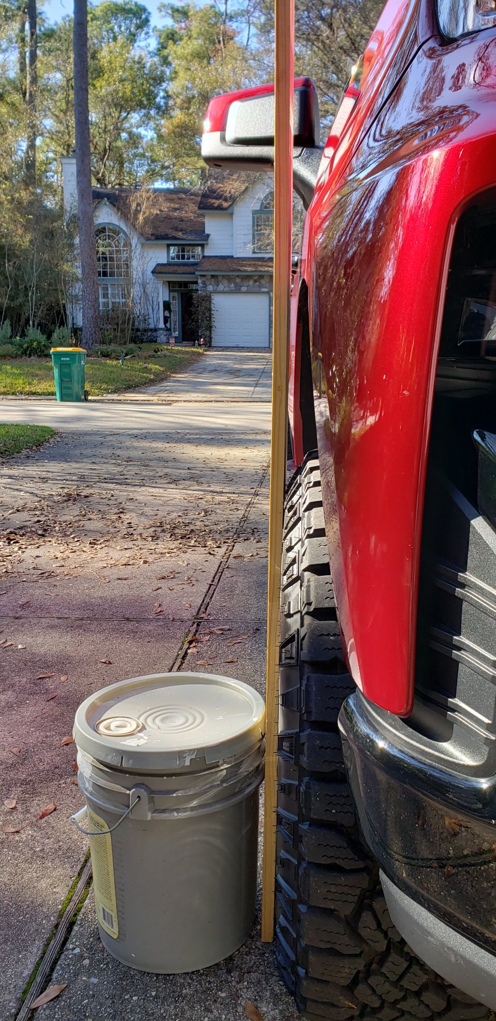

Swiftks, how much tire is sticking out of the fender? looks like a couple inches.
Well it wouldn't be a couple inches, because the spacer is only 1.25".  Also, the wheels on these trucks are somewhat sunk in the fender well a bit I noticed.
This is about as scientific and accurate as I can get.
The 1x4 is flush against the bottom and top of the tire, with paint bucket holding it in place.
Gap looks to be right at 3/4".
Also keep in mind these Duratracts are 11.0" wide I think (via Goodyear's website)... if you go wider in tire size, divide by two (b/c half the additional width goes on the other side/inside of tire), and add to this measurement.

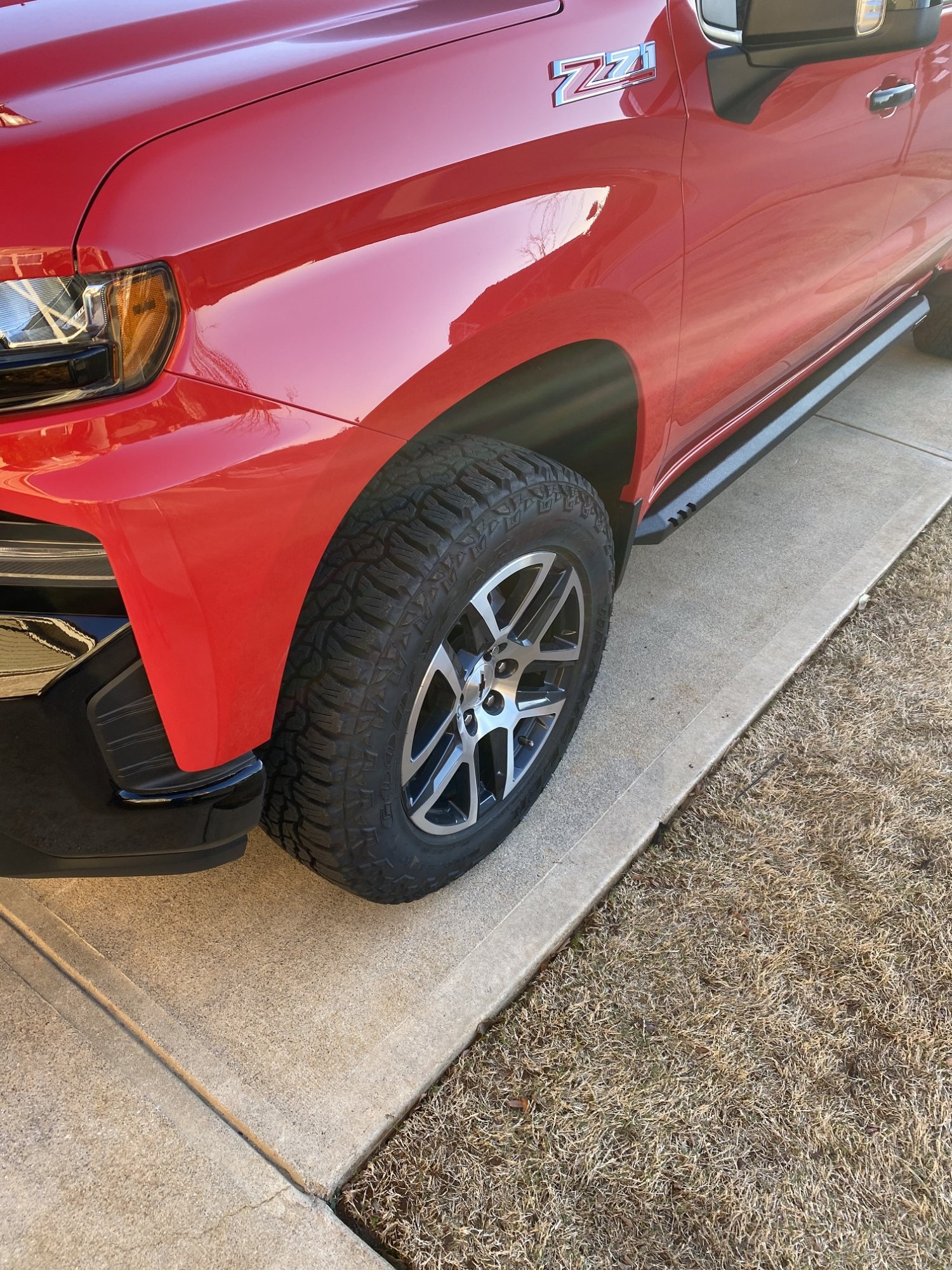

1.25" hub spacers Installed.  I did have to break out the Dremel and trim a bit if the inside of the mud flap and some of the wheel well insert, but nothing is rubbing at full lock now...
Turned out good.
