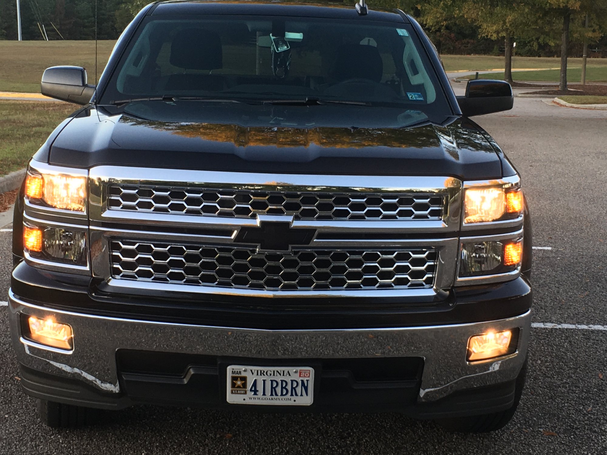

Nope just pull the gold one off. No need to remove the grill. If you have some trim removal tools or in my case I used a plastic squeegee thing for tint or vinyl and work it from the top corner comes off pretty easily. New one pops right in.
Ok cool, is it glued or are there plastic retaining clips?
4 clips. Get one corner lifted up and it basically just falls off. Literally takes 30 seconds to swap.
Thanks I'm gonna order one.
