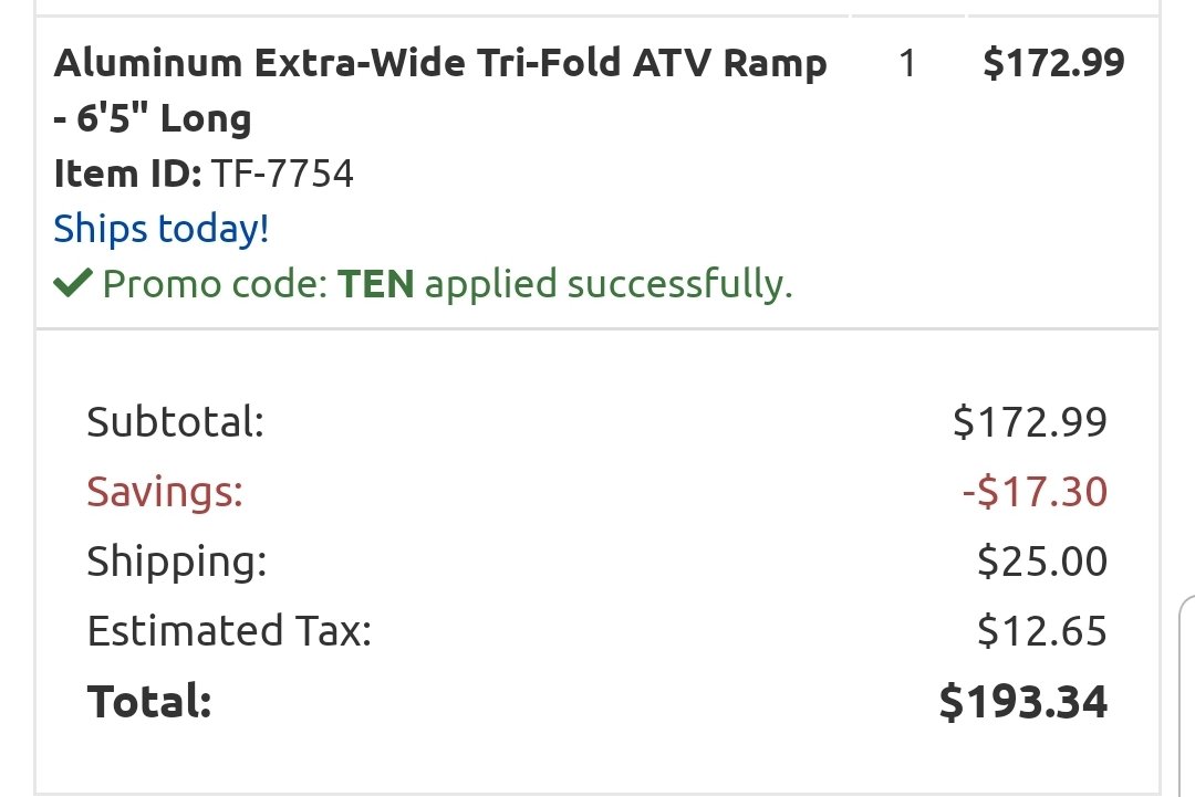

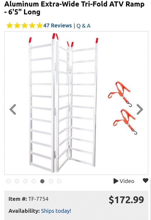

That's good to hear! I've got some questions for you please. 1- Do you have the 5.8' bed? 2- Are you loading a full size atv? 3- Is your BW ramp the that is 50" wide like the one I've attached? Thanks in advance.

Yes, I have the 5’8” bed. It’s a full size Yamaha Grizzly 700, and I bought the 50 inch wide ramps 6’5” long. It has worked well so far. I think with shipping the total was around $160
MR Truck - Just my luck - Haha!
I would like to make one clarification for anyone that may later need this information. Based on my measurements of the tailgate, a 54" wide ramp is best to completely extend beyond the inner section of the multipro tailgate that can lower. A 52" wide ramp may do fine but what's a few extra bucks to be in the clear and less worry?
Note: To clear up any confusion that may have arose over some talking points in this discussion: The specs on the black widow extra-wide ramp is actually 54" not 50".
Thanks again for all the info MR Truck!
