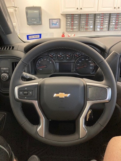

After researching the addition of radio controls on the steering wheel, I've concluded it can't be done without a huge hassle and expense.  As an alternative, I swapped in the leather steering wheel and used the blank on the right side of the stock wheel that came on my 2020 Silverado Custom.  I have Katzkin leather seats so I wanted a leather wheel to match so at least I have a nice steering wheel instead of the cheezy plastic stock version that came on on the Custom trucks.  The cruise control buttons on the new wheel work fine.

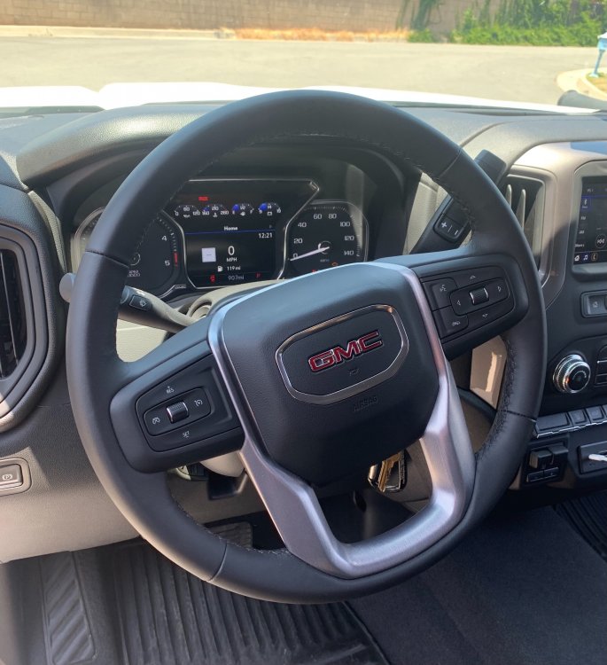

I was able to work with the Harness Dr on my 2021 Sierra 3500 base, to get this working. I added the programmed cluster from WAMS, a steering wheel with the menu controls on the right and audio controls on the back. We added 1 wire (now available on Harness Dr website), which required no splicing, pinned at the cluster and pinned at the clock spring harness and this gave my wheel full control. Well worth while upgrade.

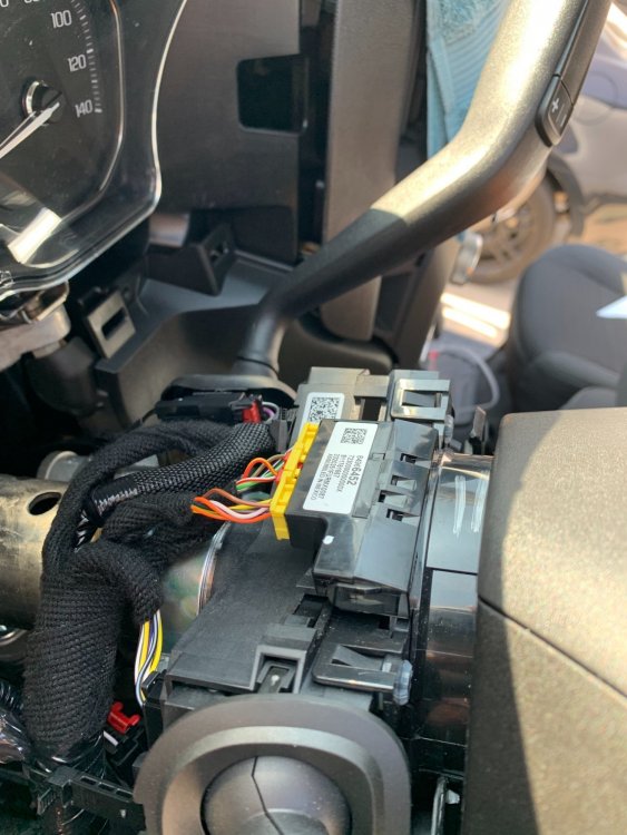

Hey Mac-427, I’ll try to add some detail so forgive the long post....

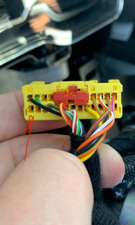

the first thing I would do is remover the upper steering column cover, to expose the clockspring harness (yellow connector). If you remove the harness, you can verify if there is any existing LIN bus connection (slot 9). If there is no connection, you should be able to run a wire directly from slot 9 at the clock spring along the existing harness to slot 20 at the cluster connector. I would really recommend going to the Harness Dr. website and purchasing the wire for $26. It will come with full instructions (many of the pics are from my upgrade, just saying that as verification it worked) and it is pinned perfectly to fit in the slots.
Just as an FYI, I DID NOT replace the clock spring, as I’ve seen many people believe that may be necessary for this upgrade.
This upgrade has had at least 2 additional successful attempts that I’m aware of, to this point.

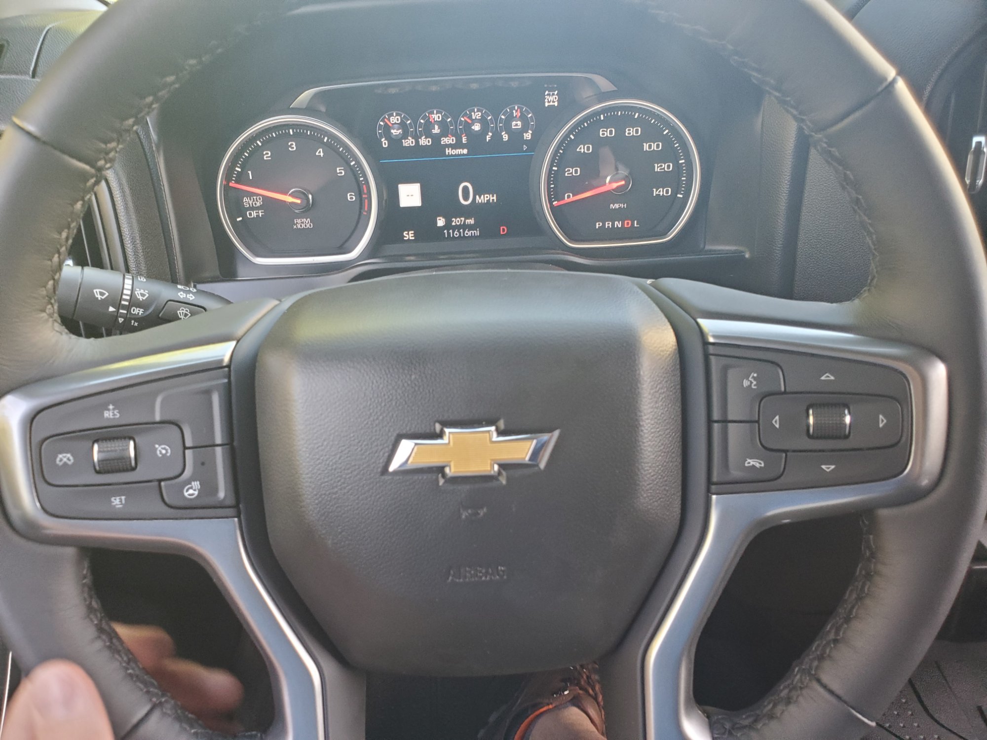

Here are the before and after photos....
I apologize, the before photo is the dealer stock photo, I didn’t take one prior to the install...

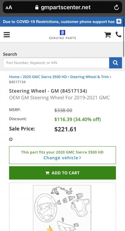

I completed this and everything works except the heated wheel. Ordered a high country cluster from whites, wire from harness dr and a wheel from the dealer. Cost me about 1k to complete. Yes that's alot but its really nice..!! Since it's a custom the stereo bezel didn't match, I ordered the silver one to match.
