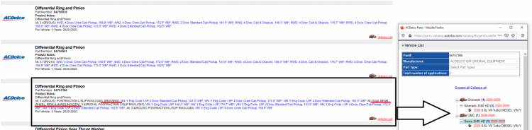

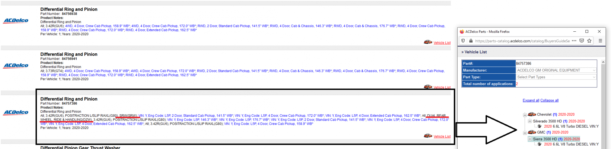

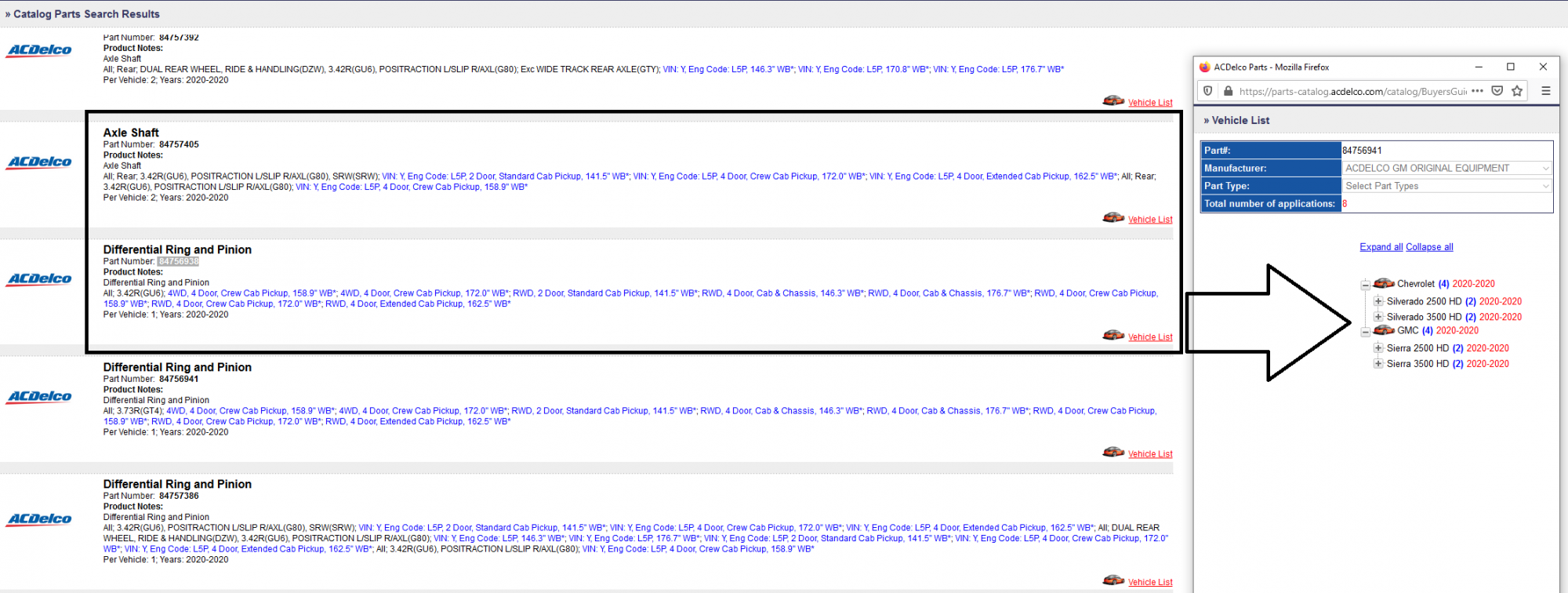

I did some research on ACDelco's website (https://parts-catalog.acdelco.com/catalog/catalog_search.php).
I noticed that it seems like getting the 12" rear is an "it depends" kind of thing. The 11.5, at least from this part catalog, can come on a 2500 or 3500, however, it also appears that the have a specific part for the 3500HD as well, both in SRW and DRW.  This is the way I read into this: If you buy the DRW, you get the 12". If you buy a 2500, you get the 11.5. If you buy a 3500SRW then there a chance you get either 11.5" or 12" depending on the specifics of the order.
Either way, I also see there is conflicting views/articles on the torque limiting in 1st. Who knows what is true on that one?

The parts house will sell you anything that will "FIT" your truck. What comes as a STOCK order and what comes as a SPECIAL ORDER will be up to you when you order. I will call the service department and ask what they show, as to the options available.
