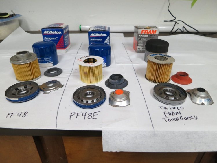

Not the 63, but the 48. Construction is similar, though.  Sometimes, new and improved sucks.
