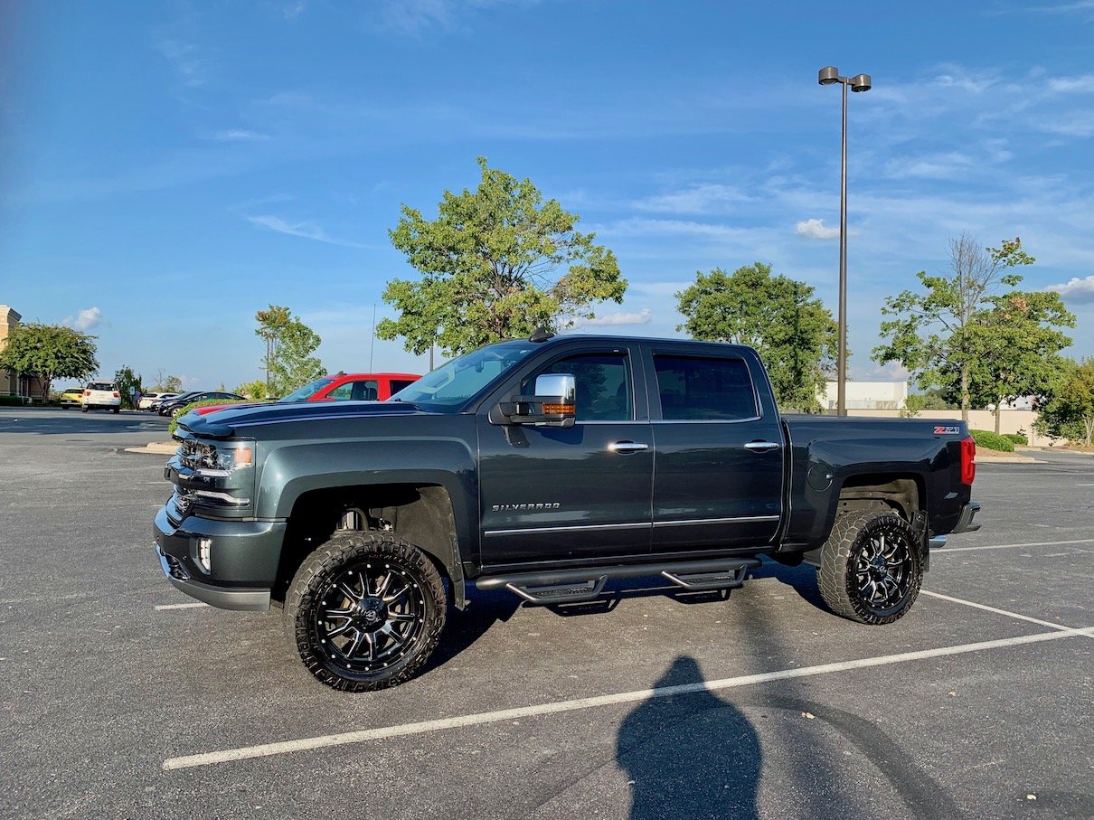

Wish I could help, but it's not apples to apples, but close. I put a 5" RC bracket lift on my '17 and have bilstein's in the front at stock height and Fox in the rear on 20x9 19mm offset, fuel rims and 285/55R20 tires. When I got the tires, I only had the bilstein's up all the way and 295's rubbed. I will go 295 or 305 when new ones are needed. I also have WeatherTech mud flaps on. Again, not completely the same, but I do not have issues with rubbing or excess mud flung up on the panels/doors. The truck does not sag at the rear either, the angle I took the picture was horrible. LOL The 5" bracket lift is around $1100. Might find a deal here or there too. GL

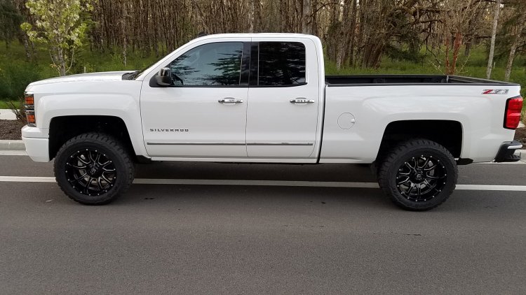

I know everyone hates it but I've been running the Rough Country 3.5 knuckle lift kit for 15k mile. It raised the front 3.25" and rear 1.75".  No pinching of Upper, lower ball joints and tie rods. It rides just a hair stiffer in the front. No rubbing with 20x10 -19 and 33x12.5 toyo rt.20190424_194507.thumb.jpg.c0679460d10be4e508841baf45fef564.jpg
Looks good, basically same setup as me for wheels and tires.
