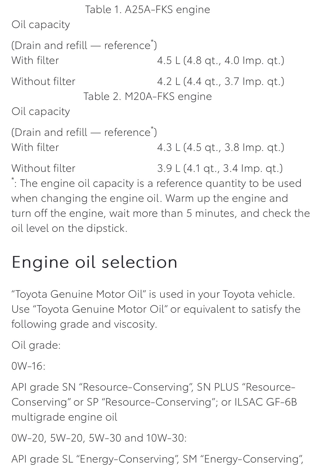

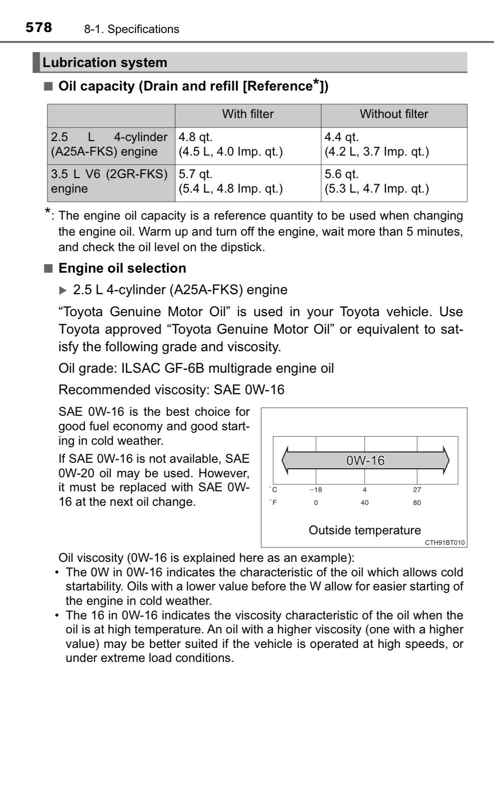

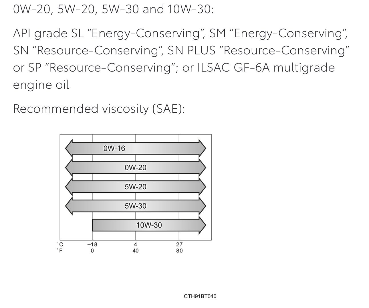

Of course. The issue is with who deems a viscosity “appropriate” and why. For example it’s interesting that the same exact Toyota engine (A25A-FKS) in Europe can use up to 10w30 if temperatures are appropriate. IMG_3791.thumb.jpeg.0db7fb554f90935dac05ba149379f92a.jpegIMG_3792.thumb.jpeg.02be0e193d1de88d14fe777521720765.jpeg
Here in the states things read a little different.
Nevermind 10w30, they scare the owner out of even using 0w20. This is nothing more than CAFE BS and we all know it.

Used oil analysis is the only way you as a consumer will know if its OK to change the recommendation for a particular area.  It's your car do what you want to do!  Who cares what CAFE requirements are? Especially if you are convinced its all BS.

You’re missing the point, probably on purpose. Europe and the US both have conditions that can vary from tropical to polar. Don’t you think it’s a little odd that the manual for the US implies that anything heavier than 0w16 is unacceptable while the same engine in Europe allows for anything up to 10w30. What’s the difference here besides impossible CAFE standards to achieve? It sure looks to me that viscosity is being selected based on efficiency, not wear protection.

I did not miss YOUR point. I shared my advice. Enjoy a point of view from JASO you might have not thought about.
In Japan, the JASO GLV-1 classification, which targets SAE 0W-8 and 0W-16, was developed as a standard with low viscosity, excellent fuel economy and engine reliability and has been claimable since October 2019. In Europe, the major step is the introduction of lower viscosity SAE 0W-20 oils, with the focus on excellent fuel economy while maintaining engine durability across longer engine oil drain intervals (ODI).
https://www.infineuminsight.com/en-gb/articles/designing-more-sustainable-lubricants/

Depending on where in the world you are, the Mitsubishi 3A90/92 engine calls out anywhere from 0W20 to 20W50 :omg:
