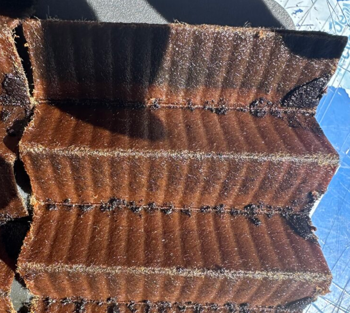

WHY?
"The EC30 cleaned so quickly on our 2000 Volvo V70 that I’d be reluctant to start with straight HPL.
I prefer slow cleaning by using EC30 or EC40.
Picture shown after running 5 quarts M1 0W40, 1 quart EC30 for 5,000 miles."
