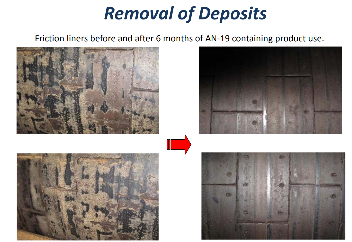

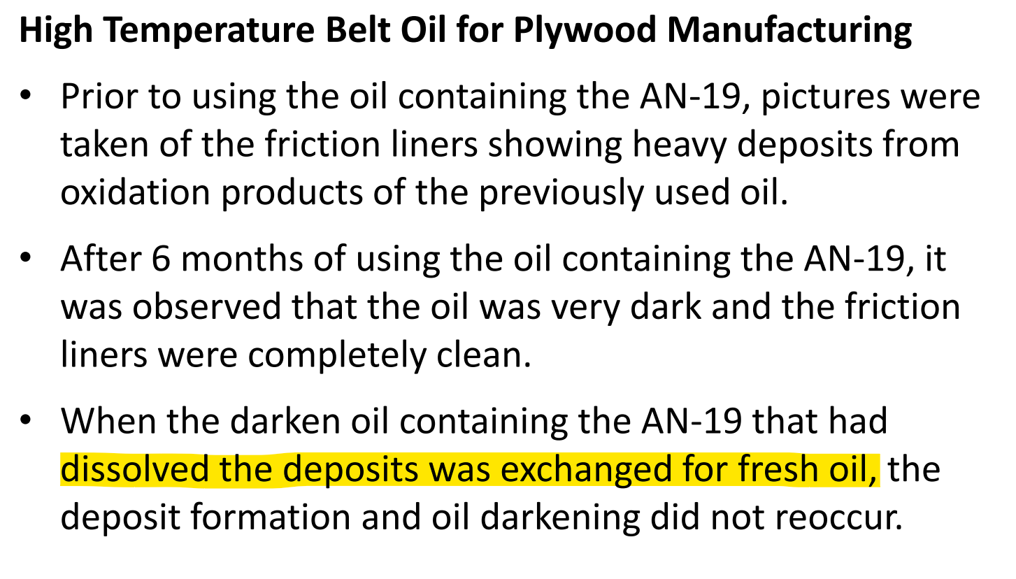

Amsoil has very good solvency.  Their oxidation values range from 50-70, but more importantly they're apparently using some type of proprietary ester (hundreds of different ester types).  Amsoil cleans very well.
Mobil is rumored to be using ANs now in most if not all their formulations.  The 0w40 and ESP used to contain POE and on the PDS would state "Exceptional cleaning power of dirty engines".  That language is still used but the oxidation values are now under 10 across the board.  They are mostly likely using ANs which clean very well.
