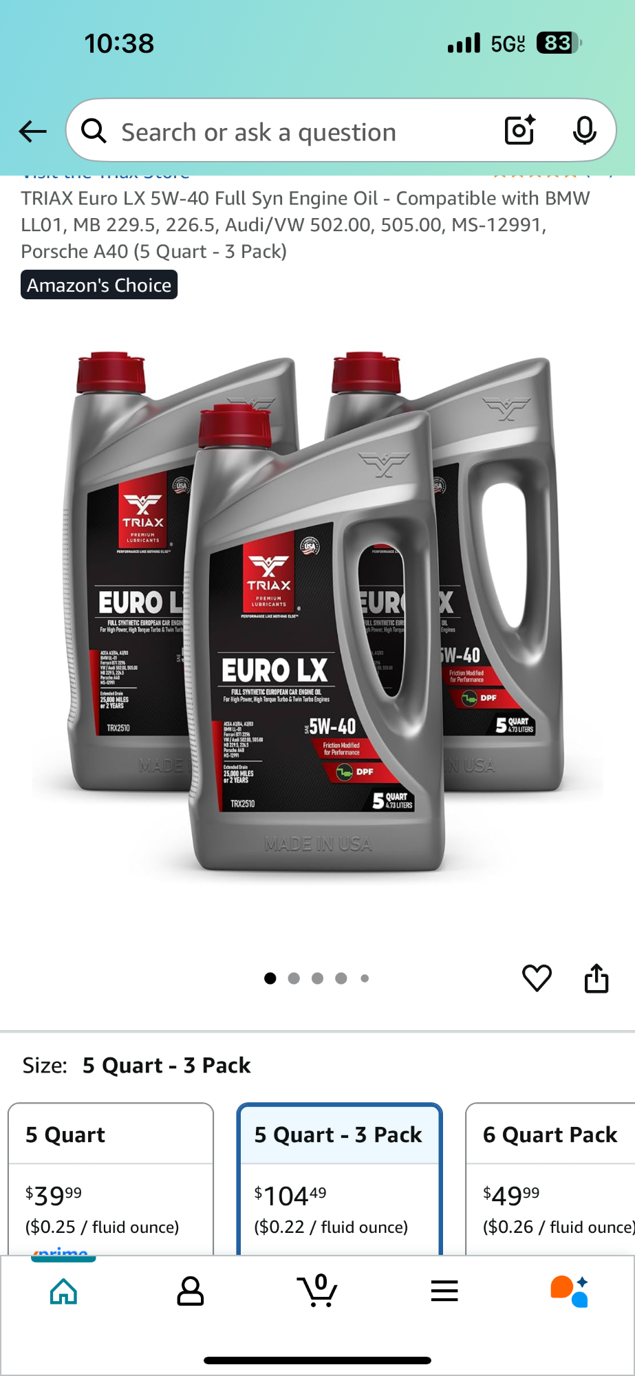

Should be this one, no? Like many companies it seems buying by the single quart is a great way to overpay.IMG_4166.thumb.png.81e4d24f93e36b2314c5a7b0f6c3eefa.pngIMG_4167.thumb.png.ed7a3422381b863f64c7b61c5a4ca98a.png
I don’t have a home for this stuff anyway but a VOA would be interesting.

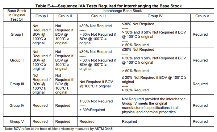

API Donuts and DEXOS base oil requirements
Study this and contemplate what this means about getting an API certification. Then perhaps you will understand why oils like AMSOIL SS, Red Line HP, Torco SR-5 and many HPL oils don't have donuts.
https://www.api.org/certification-programs/engine-oil-diesel-exhaust-fluid/~/media/files/certification/engine-oil-diesel/publications/appendix-e-rev-09-01-11.ashx
Go to Practical Lubrication and Filtration and note the POSSIBLE viscosities producible for each base Oil Group. Then note at the bottom of the chart how interchange is tied not only to Group but to the original blends base oil viscosity and finally to a qualifying percentage.
Give cost of certifications for coloring outside the line it should be easy to see how the industry 'protects' self above actual wear protections.
Also note, as an aside, that the more refined the base the lower and narrower that base oil become meaning? You are not getting more than an SAE 20 from a straight up Group III. That oil is not just specified to meet EPA CAFE requirements but to meet the lowest cost bar possible while boxing out all challengers.
Only the largest or most well equipped blenders will be able to meet the financial burdens. Mobil and Valvoline examples. DEXOS follows the same rules with slightly tighter standard on a few tests which make it look like something more than it is.
It has darn little to do with how great the OEM Engineering staff is and a whole lot to do with $$$$ and exclusivity.
Edited by Grumpy Bear
In the Above
Note that ALL Group V fluids are boxed out? Esters, Alkylated Naphthalene. O-PAG's. So unless the original qualified oil contained them to begin with, then replicating is as good as it could possibly get.
You could not add a Group III or IV to a Group II oil whose original 30 W rating was brought about by natural viscosity. That equal to or greater than symbol precludes it use. m-POA excepted but wasn't really a mainstream thing in 2011 when the rules were drafted. Ops! Still it would be boxed out on economics. Oh, this is a well thought out plan.
Oils like those mentioned in the first paragraph above live on reputation to survive. It also says that IF the percentages were low enough to qualify for a read across it would have a donut. So..... ya kind'a have a basement.
Put on the coffee and open the link above and stare until the lightbulb turns on. Read each qualifying test. The only thing that prevents a POE from being API approved is the rule of interchange cause it blows the original bases out of the water in every test that matters. Much the same could be said of the AN's.

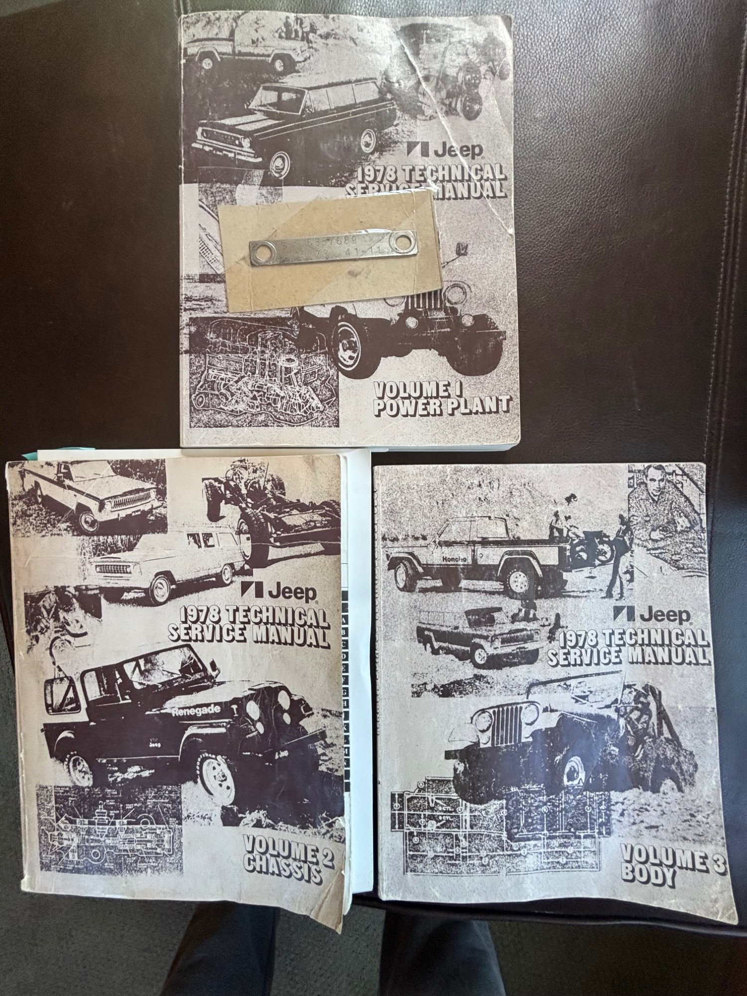

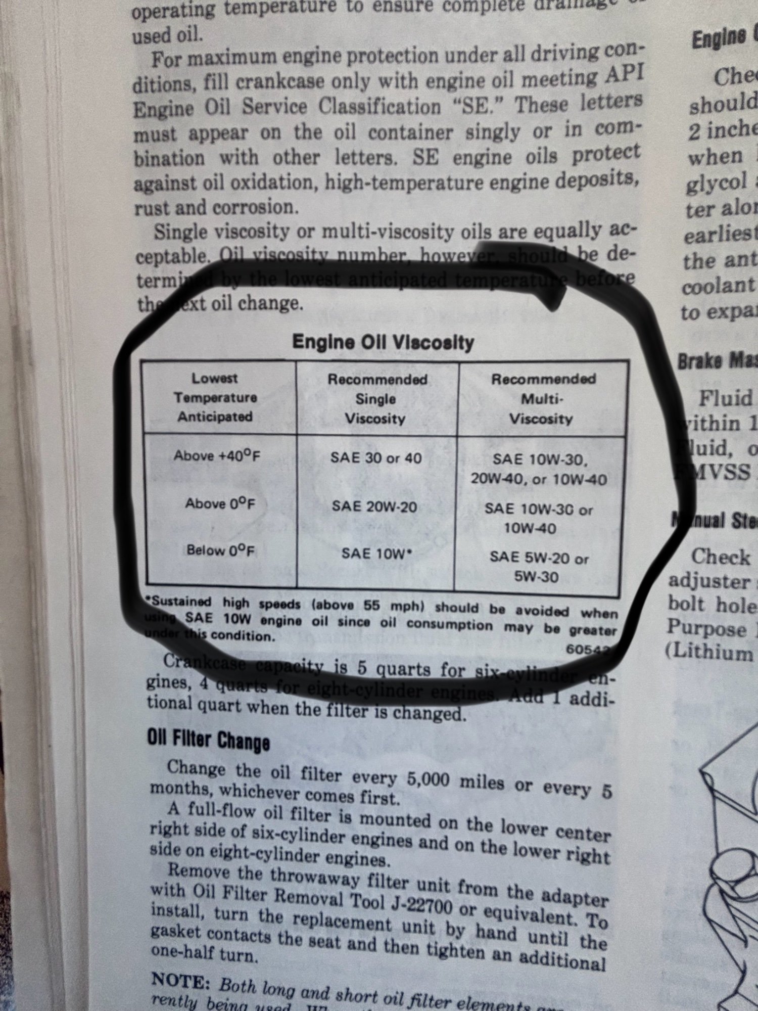

Check out what the engineers at AMC Jeep thought in 1977-78  timeframe.
Grumpy keeps talking about the J300 SAE 20 Viscosity range of being something special  .
It’s not!  The current SAEJ 300 SAE 20 range COVERS SAE 20, SAE 16, SAE 0W8.
NOW LET’S TAKE A LOOK AT WHAT AMC JEEP ENGINEERS thought  ABOUT EVERY ONE OF THEIR V8 THE 304 THE 401 THE 360 AND THEY’RE 258 IN-LINE SIX.
TAKE A LOOK AT WHAT THE OIL RECOMMENDED FOR A STRAIGHT VISCOSITY SO YOU GET AN IDEA OF WHAT THEY WERE CONCERNED ABOUT AT OPERATING TEMPERATURE ABOVE 0°F. THEN TAKE A LOOK AT WHAT THEY WERE CONCERNED ABOUT IF YOU OPERATED ABOVE 40 F ALL THE TIME  THE STRAIGHT Weight RECOMMENDATIONS GIVE YOU A GREAT IDEA OF WHAT THE AMC ENGINEERS WERE THINKING THAT WOULD OPERATE THE BEST IN THESE MID LATE 70S ENGINES in FULL size trucks and Jeeps.
grumpy is absolutely correct that dynamic viscosity at the design temperatures for that engine or what you want to run as an engine oil. But not because of just where they were concerned about the power cylinder, ring seal being near perfect or as best as they could keep it that at the 5000 mile normal drainable that was recommended. If the engine was operated in any stress mode, the oil change interval was recommended to be somewhere around 3000 miles or less. Remember this is on very cheap solvent refined group one lubricant with very little an additive package. The added package that was used in the 70s was so poor that anything that was polymeric was a cheap polyester and it formed secondary deposits. That’s why  the oils WEREW LOOKED DOWN UPON  during that time by OEM’s because the oil manufacturers couldn’t do it right.  THE VISCOSITIES OF THE OILS WERE LESS CRITICAL THAN THE QUALITY OF THE MOLECULES BEING USED TO MAKE THE OILS.  IT’S STILL TRUE TODAY IF YOU’RE MASKING AN ISSUE IN YOUR ENGINE BY ADDING HEAVIER, VISCOSITY OIL MORE THICK IT’S NOT NECESSARILY THE IDEAL.
IF YOU RUN A 5W 40 OIL IN AN ENGINE THAT CAN RUN OPTIMALLY ON AN SAE 0W 20 OR AN SAE 5W 20 OR A STRAIGHT 20 IF YOU CAN FIND ONE 20 W 20 THEN YOU’RE JUST WASTING ENERGY ADDING A HIGHER OIL AND TO KNOW THAT THE ONLY WAY YOU’RE GONNA KNOW THAT REALLY IS TO ANALYZE THE OIL LIKE GRUMPY DOES.
CAFE was not even a factor until late 80’s for trucks.
