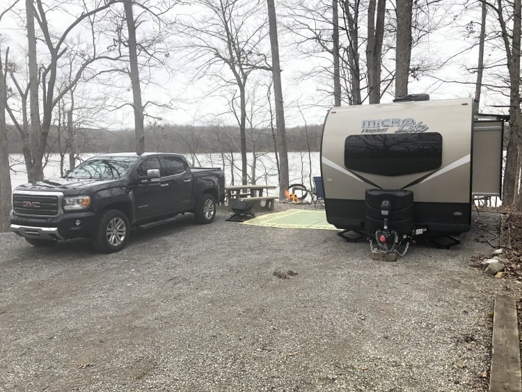

This fall I purchased a low mileage 2016 2.8 SLT when I upgraded my TT.  The TT is about 5100 LBS loaded and this little beast pulls it with no problems and gets 15 to 18 mpg while doing it. That’s mostly 2 lanes in Kentucky and Tennessee with a max 1 way pull of 3.5 hours. So far I’ve been very pleased with the DuraMax. The only modification is replacing  the factory mirrors with Boost Auto Parts towing mirrors.  I have no experience to comment on your weak frame question.
