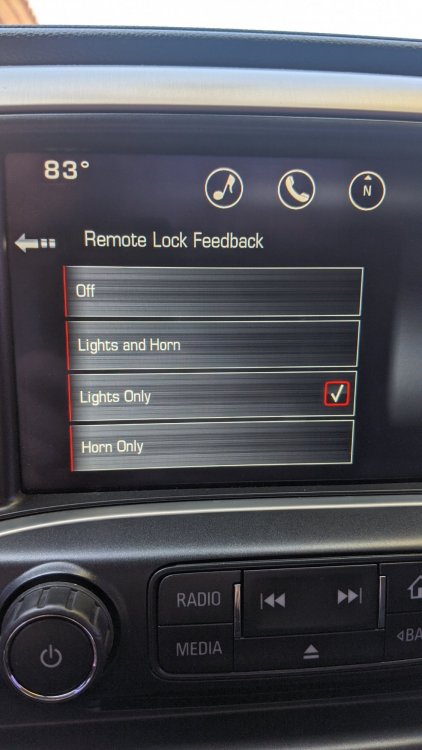

It looks like you have it set for lights only. Is it still honking, Jimmy?

Go in to your infotainment settings. You can set the lock sounds there, as well as a number of other items.
The lights/horn feature in your vehicle settings only affect the first press of the lock/unlock buttons.  It should lock/unlock on the first press of that particular button.  Second press of the lock button, it should honk, UNLESS you wait for more than a second or two before pressing the button a second time.  If you have folding mirrors, you can tell the truck to fold them when you lock the truck, and likewise when you unlock the mirrors will unfold.  Just hold the lock or unlock button for 1 second, if you hold the unlock button for 2 or more seconds, the windows may roll down.
