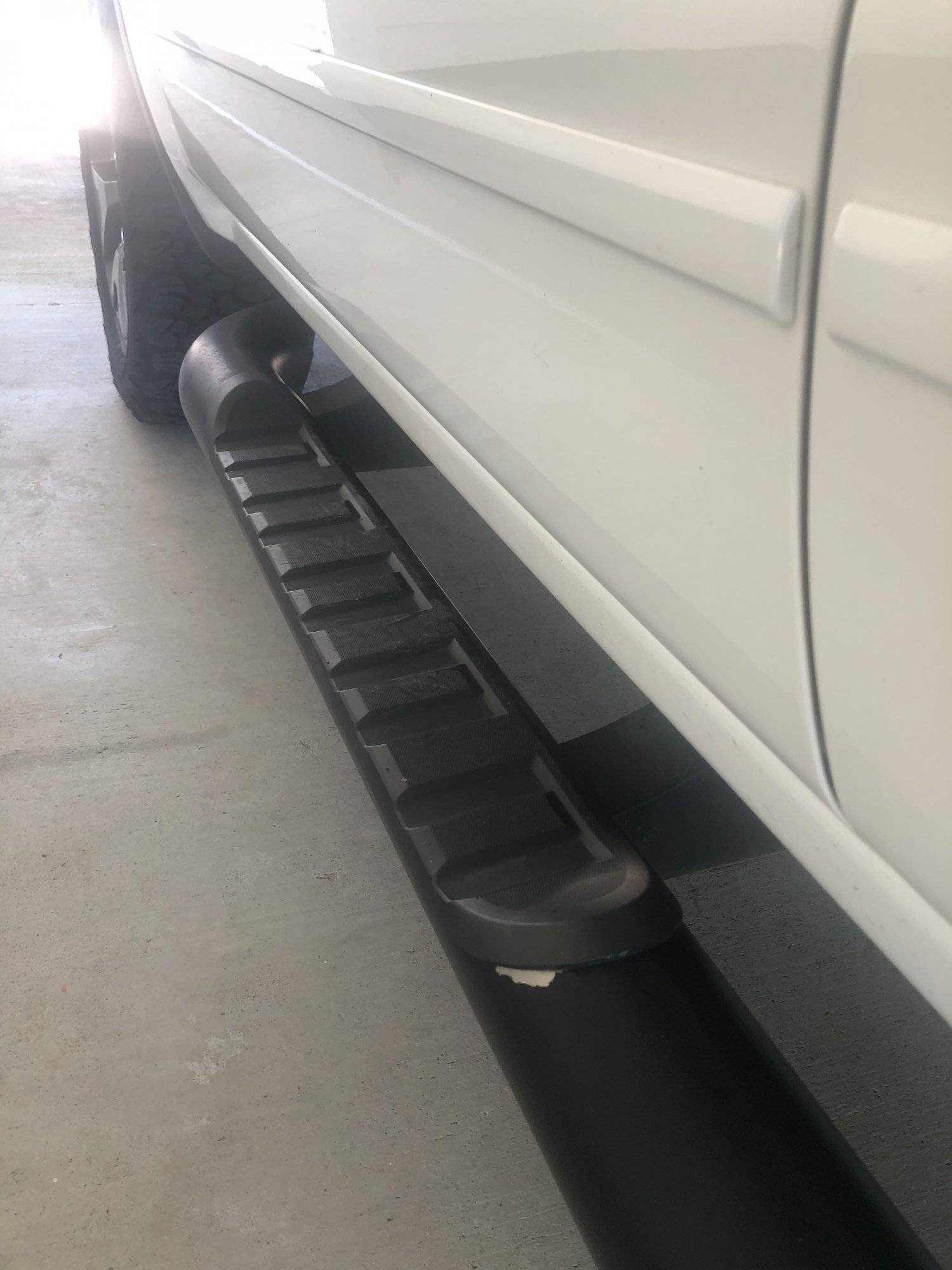

Does this piece come off of step bars?
My step bars are chipping and i was thinking about having them repainted. Does the plastic pieces come off of them or are they glued on? How would I get them off?

My guess is they snap on and they can be pried off from the top. try taking a putty knife to it.
They do snap on and off but as previously suggested new clips will likely be required. I think the effort will exceed the benefit and I'd touch up the chips while leaving the step pads in place. and the bars on the truck.  Sometime in the future you may decide to treat yourself to an entire new set!

Snap out and they’ll snap back in?
Should.  If any tabs snap you'd have to get a new pad.

Or glue those back on.  I'd try it.

I powdercoated mine, i bought them used, they were chromed, i had them coated semi dull black. I've never liked them shiny.
It was about $30 dollars.
the  rubber/plastic i took off by pushing the clips from the bottom.
your should have access holes, look at them fro the bottom.

What are your plans to repair the chipped paint? Mine are doing the exact same thing I actually posted a similar question just last week.   I plan to keep the step pads on but you can remove the bars from the mounting brackets with a few bolts, i think.
Part of me wants to try to sand, prime , paint.  Other part says bedliner.  Other part says just do minimum necessary to touch up but I am doubtful it'll blend and I have some decent sized pieces fall off
