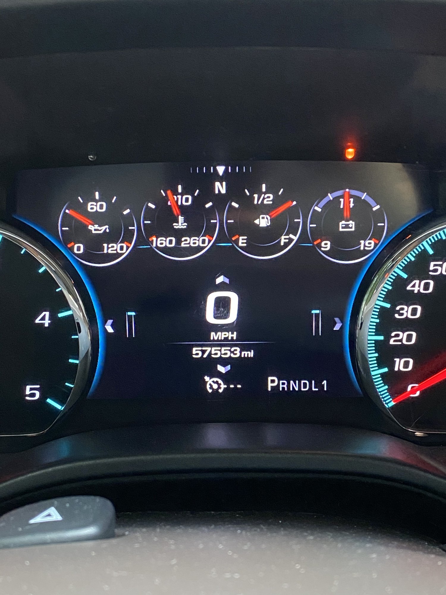

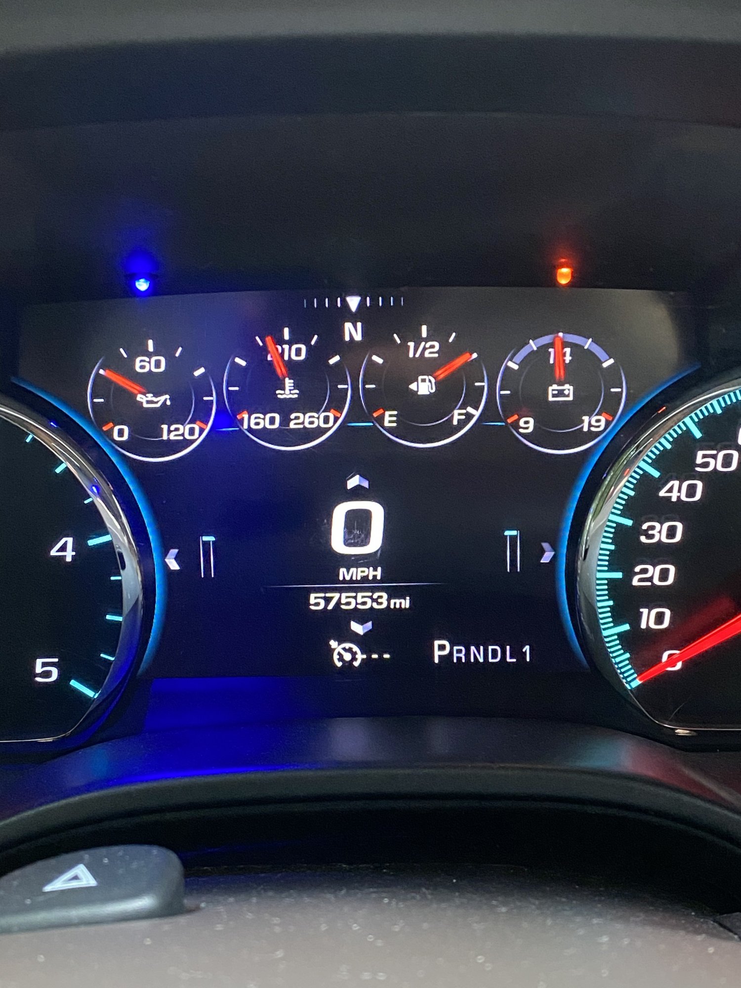

I mounted a small yellow LED in my speedo and wired it to the Transfer Case Control Module (X1) pin #12.  Put a blue LED in there as well to let me know when my light bar is on.
Any Photo's ???? Thanks
Here's a shot of the 4x4 indicator.

Here's a shot of the 4x4 indicator and light bar indicator (it's blue)...
I control the light bar via a pneumatic foot switch that I placed on the dead pedal.  I bought it from Pressair if anyone is interested. I hit my limit on photo uploading so am unable to post the picture.  If interested you can navigate to:
https://paauto.weebly.com
where I've posted a bunch of pics of my mods to the truck and the wiring diagram.  I've made a bunch of additions/changes since I posted those pics, but you'll get the drift.
In any case, I wired a master switch (located in the center console) in series with the light bar foot switch so I can be assured all power is cut to the light bar and it's not inadvertently switched on (i.e. by my 17 y/o daughter who loves to drive the truck with her friends!).
