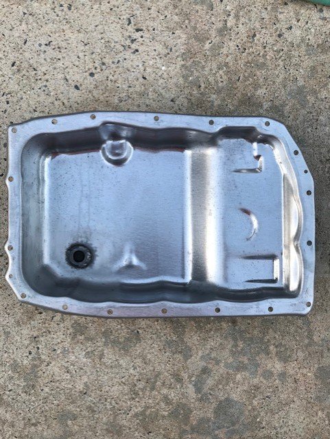

Looking for recommendations on a replacement transmission pan for my 2016 Silverado with 5.3 and six speed automatic.  I want something with a drain plug that will also drop the temperature a little when I tow.  My temps go over 200° when pulling a 5000 lb travel trailer uphill.  The truck will be going to Arizona and will be pulling a 2800 lb travel trailer, so I'd still like to cool it down a little when going over mountain passes.  Thanks.

And I welded a nut on the inside of the pan for my 4l80e and a drain plug, job done for cheap.  If you don't weld/braze, then I would suggest a cheap stock pan with a drain plug...

A pan with a drain bung is going to run you a ton of money, it would be cheaper to just have a bung welded to the stock pan.

Why couldn't you get an 02 bung welded to the outside of the pan. I know on my old vette I have an extra bung welded to the exhaust for tuning and the bung came with a plug and it seemed the bung was only a few dollars.
I just purchased a drain plug from Summit and welded it to the pan for our 2016 Suburban.  Works great.
