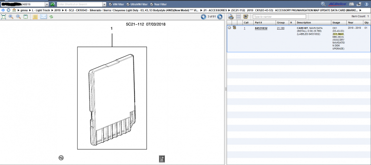

Did they actually call GM Techline to try and get the truck calibrations?  It sounds like they are just relying on the accessories catalog and saying its not compatible.  The GM Accessories catalog that the dealer uses constantly has parts removed, updated, etc. so things won't show up in there correct.  I always have to double check info on there as its always down/broken/numbers change.
Unless...GM is no longer supporting the upgrade and Techline isn't doing the upgrade.  I wish I had a truck here to test this all out on but I don't unfortunately.  I might later this week though as I had someone call about this on Saturday.
Here is the GM EPC with your VIN showing the card as compatible.  Note your IOS radio code is highlighted which indicates a matching part based on the VIN.  If you didn't have IOS radio, the card wouldn't even come up for me.
