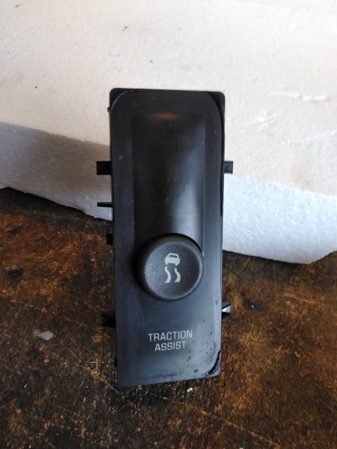

Traction control was available as early as 2001 or 2002 in the Silverado/Sierra trucks. It was not a real popular option.
It would have a button like this and usually was installed on 2WD vehicles and maybe some 4WD in the SUV's.
As said above, stabilitrak came in the GMT-900's.
