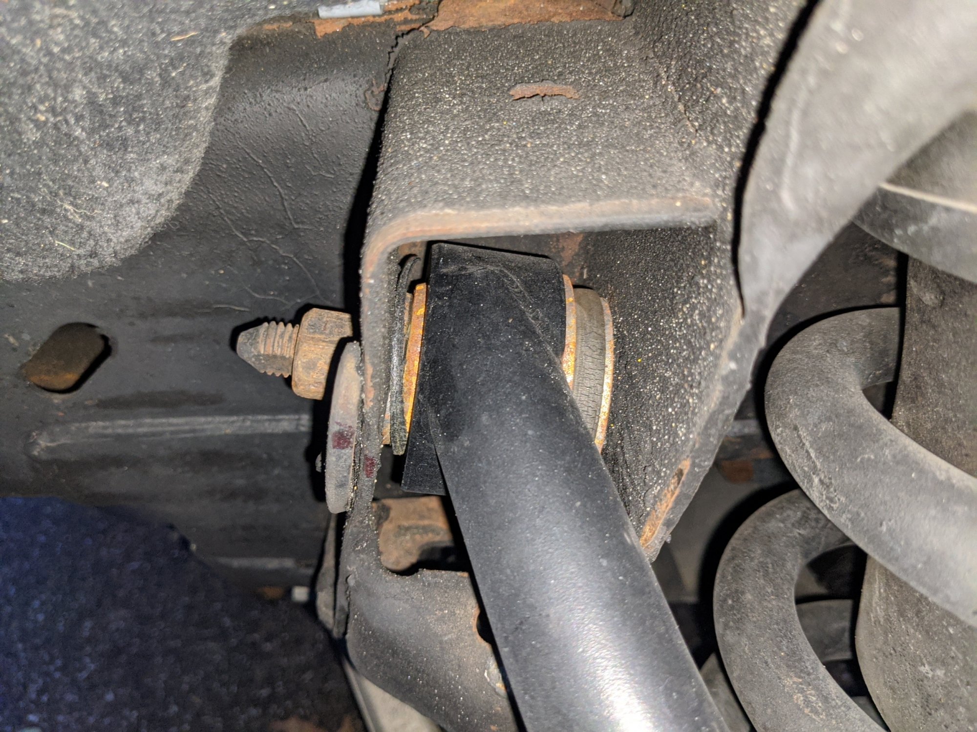

Anyone else running the aftermarket motofab upper control arms for 2.5"-3" leveling kit on your trucks?  I installed mine about 4-5 months and 10,000 miles ago and the bushings are failing.  Wondering if this is a common problem with these control arms.  I know they have not been in stock for quite some time didn't know if it was a supply issue or they were having problems similar to what I'm experiencing.  After reaching out to Motofab they did say they would send out new bushings waiting to see if it's the same bushings I have or better.  Just hate putting more money into it to have the same problem later.

@TriZZZl3 not running stocks aftermarket 22" Hostile wheels with -24 offset I was planning on swapping out  for stocks during the winter but now a little concerned with @53boy post off rubbing on stock wheels.  Yes they did send the replacement bushings for free mo charge to me just concerned putting more time and money in the same product.  If anyone has any suggestions for a good quality aftermarket bushing for UCA let me know.. Thanks

I installed these about two months ago.  Just started having issues in the last week.  The bushing on the left side is already failing.  I would stay away from these to be honest.  I haven’t reached out to Motofab yet, but hopefully they send replacements free of charge.  Even then, I hate to spend money on replacing them if they’re going to fail again.

Just wondering if you’ve had any issues with your UCAs?  One of the bushings on my left side is failing.

So far no. I can see one side of the front bushing starting to crack though. I’m almost positive I’ll be ditching these control arms within the year .

Just curious if you installed the replacement bushings from Motofab, or if you went with a different one?  They are sending me replacements free of charge, but I'm wondering if I will be wasting money putting the same bushings back in there?  Thinking about biting the bullet, and getting Ready Lift UCAs instead.

I'm looking at Ready Lift UCAs.  Hate that I just spent $300 on the Motofabs, and the cost to install.  However, I'm hesitant to install replacement bushings if they're just going to fail again.

The Motofab UCAs I have do have Zerk fittings and the installation instructions recommend not greasing upon install as they are pre-greased from the factory.
However, as with all bushings, they should be monitored over time in case new grease is required.
