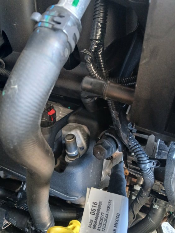

I will make this very long story as short as possible.
Less than 10K.  Many trips to dealer due to engine light and running rough and also going into reduced power mode.
Finally able to identify bad injector in one of the cylinders.  They replaced it.  When I picked up the truck, the mechanic showed me the injector.  Reminder... less than 10k on the motor.  There was already coking and carbon deposits on it.
I went on to ask the mechanic if the intake had oil in it.  He said the intake was coated in oil.  I said, "So, this engine will benefit from a catch can...?".  The mechanic said, "It will for sure".
I had one on my '17 1500 that I emptied regularly.  I have yet to put it on my 2500.  After my conversation with the mechanic, I will be putting that can on this truck ASAP.
Will it void your warranty is the obvious next question...  it depends on the dealership.  There is no pat answer to this.  So, if your worried about it... and your truck is still under factory warranty... ask your dealership... If they say it does then go to another dealership.  The one I used could care less that I had a can on my 1500.
No more discussion needed guys and gals.
  • Haha 2
Great question.  One I did not think to ask... and, frankly, I dont know if its possible to determine that.
Regardless... For me, the can is going on due to the intake being coated in oil.  The mechanic was very clear that it was "coated" and that a can would mitigate it.  That is enough reason for me and I am not concerned about the warranty because, with this truck, its an easy on and off (easier than the 1500).  So, if needed, I can take the can off before going to the dealership.

10,000 miles?  Cylinders, valves, and injectors have carbon deposits on them in as little as 3000 miles.  It's a sad side affect of direct injection engines.  Same with the oil in the intake.  Very important to run good top tier fuel, as well as additives to address the carbon build up.  This is the case in all modern direct injection engines.  Regardless of manufacturer.
I am so glad you mentioned top tier fuel!  The mechanic said the same thing.  I am a bit embarrassed that I didn't know what the heck he was talking about.
Well, I knew some companies had better gas than others... I knew some companies had more additives than others... But, I didn't know anything about Top Tier Fuel.  I looked into the matter once I got home and sure enough... So, anyway.. learn something new every day...  Lucky for me, Costco is on the list and there is right one right down the road from me.
So, to put the matter of a catch can to bed for once and for all (there are endless threads about the subject out there), and since the inception of the 6.6 there has been lots of questions about whether its built in oil separator is enough, I think I can safely say:
1.  Almost any DI engine can benefit from a can.
2.  The warranty issue cant be answered in a black and white way.  You must figure that one out for yourself.
3.  Almost every DI engine should be fueled with a top tier fuel if you can.
By the way, I had a can on my '17 1500 and still have two full mason jars filled with oil that I dumped from it over three years.  I am a big believer in them.  My quest was about this new 6.6.  There is a lot of marketing material out there stating that there is a built in oil separator and they spent a lot of time and engineering trying to solve the issue.
For me, case closed.

So to answer the other question of what it does, its part of the PCV (positive crankcase ventilation) system. All motors create pressure in the motor down where the oil sits and crank is moving. This pressure makes its way into the valve area. Older engines just used a filter atop the valve cover and vented vapors to the air. Well the EPA does not like this so the PCV was invented and it routes the vapor back into the intake manifold via a oneway valve (PCV)to be burned. So the vapor contains oil and water vapors. These vapors if in too much quantity can coat the intake manifold and are sucked into the engine to be reburned. The will coat anything in the path usually injectors or plugs. Since the plugs fire hot, they kind of self clean but not the injectors. So a catch can is installed inline between the valve cover and intake. It has a screen filter which traps the oil and water which  cools and pools up in the can instead of getting sucked back into the engine. Is it 100% effective? No but it helps. So it "catches" the oil and water vapors. It will have a removable bottom can or valve that you empty as often as needed. Now I am not an expert and may have some info wrong but that is the gist of how and why its needed. Hope it help those who asked. I used one on my 2009 G8 and it was helpful keeping the intake cleaner.
