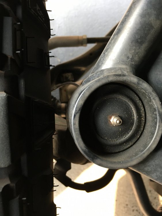

Spoke with install shop (who do a ton of BDS kits) and with BDS about UCA - neither felt it was needed for 2.5" lift - unless planning on pounding it offroad.  I use is for towing and we go offroad when towing for RZR fun - so RZR will take pounding and truck will take lighter off road duty.
I had UCA on my 2019 AT4 which was leveled with Ready Lift SST kit - they were great - but did stick out more  that stock UCA so reduced inside tire room by about 3/4" from stock.  since you have to have 0 to negative offset wheel (I had 18mm offset) you will pick up more inside room - but if you go 12.5" x 35 x 18, it will be tight on inside with 0 offset wheel.
