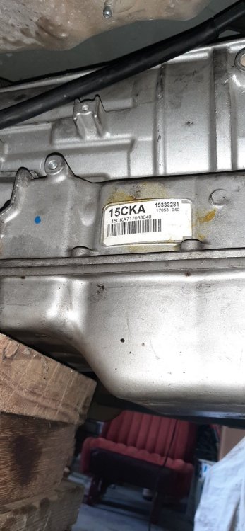

Hi guys, I bought a 2014 chevrolet silverado 5.3 LTZ with the 6L80E transmission. When I keep the truck at a steady speed ,for example 35 m/h, the transmission keeps changing rpm. It 's constant changing between 1400 and 1200 rpm. When I drive at 50 m/h the rpm changes from 1600 to 1400 rpm. It seems that the torque converter clutch is constantly engages and disengages.
I allready replaced the torque converter ,flushed the transmission and reset the computer. This didn't made a difference.
Does anyone have an idea?

Here is an update on how things are going with my tcc problem.
The mechanic I took the truck to says that when he connects the diagnostic computer and pressurises the tcc the pressure drops within one second or so. He said it's a faulty tehcm but I don't believe him. A transmission control module (tehcm) is quite expensive and is working or broken, at least the solenoid is. So I did something I should have done earlier. If you want something done right, you have to do it yourself.
So I took the tranny out again and inspected the whole thing. Replaced the pressure regulator valve with the transgo SK6L80 kit and inspected the oil pump. There was not much wear on the pump and the pressure regulator valve so I put my attension to the valvebody.
Took the valvebody appart and put in sonnax o-ringed end plugs and a transgo 6L8CSTCC (clutch select valve and tcc regulator valve kit).
But when I took out the tcc regulator valve the sping didn't come out. So I used a little hooked tool to get the spring out. But to my supprise the spring came out in 3 pices. I think that is the cause of my tcc issue. The tcc regulator valve was not working propperly due to a broken spring. And that's explains the pressure loss.
I'm waiting for the 8 plastic checkballs to be dellivered this week and then I'm going to put it all back together and take the truck for a testdrive.
I'll give you people an update on how things went.
