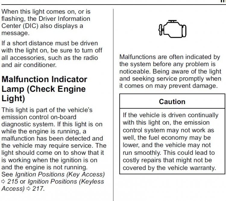

SES?  Since no one else has asked or commented, please tell me what SES stands for.  "Service" something?  Thanks
Edited by Anacortes Army Guy
Mat, we're guessing SES = Service Engine Soon? Which in your truck would be equivalent to the MIL = Malfunction Indicator Light (aka Check Engine Light). Here's a pic from my 2019 manual.
