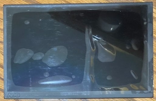

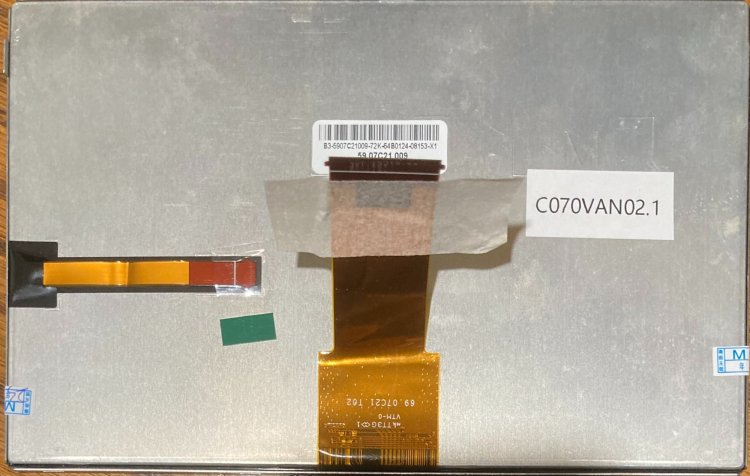

My 2015 Silverado LTZ (77K miles) radio and DIC started changing screens on its own and I came here and found this thread! THANKS to everyone that contributed!
After a lot of online reading, I decided to change the touch screen digitizer. I found a company out of Florida called CueScreens that manufactures a higher quality digitizer for $99 (Amazon). I went to their website and read about their product vs the cheaper Chinese options that are available. For me, it was worth the extra cost for the peace of mind.
After watching several of the YouTube videos, I swapped out the old digitizer with the new CueScreens one on Saturday. As of my trip to work this morning, I have not had any further "ghosting" with my radio or DIC.
