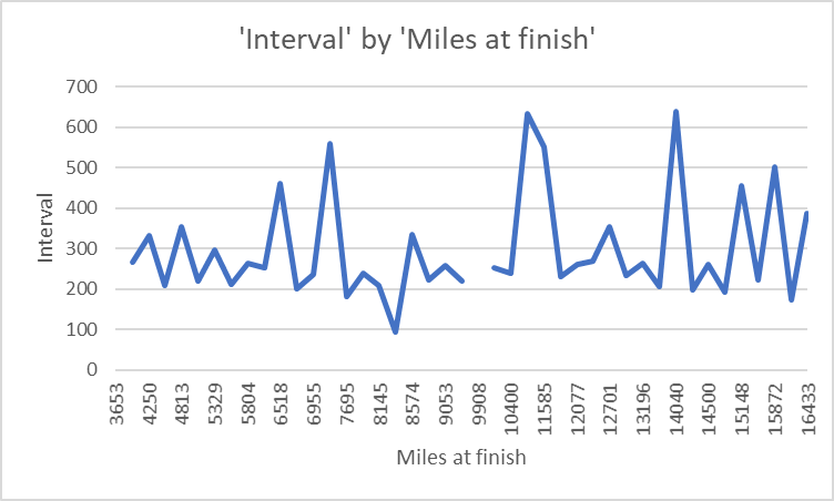

I have 16,000 or so miles on my LM2.
I installed and idash (for ****** and giggles) and have logged every regen for the last 11 months / 13,000 miles.
Some longer trips during the warm weather, but most is daily driver / local trip miles.
Despite what I expected to see, the 550 - 650 mile intervals occurred when towing. (exhaust temperature is quite a bit higher towing, but not as hot as regen)
Except for some purchase at the far end of some of the summer trips, all fuel is from the same fuel depot/cardlock.
Anyway, point of all this is that I'm not convinced a tank or two of different fuel will give an accurate indication of 'miles between regens'.
Remember --  except for a few fills, all fuel from same supplier, same location.

Can you add your fuel usage in some comparable value so we see how MPG or fuel consumption relates to your data?

What is confusing me is I seem to regen about every other day (while using the BP), but since using the Mobil, it's been 2-3 times the whole tank.
It seems I regen a lot more...but my driving is also short, local trips so I attributed it to that.
