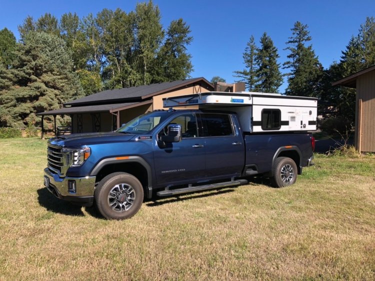

Size and weight are the big cons. Fine for open country but too big for forest roads. Heavy for sandy conditions unless you have huge tires, which are not what you want for highway towing.
Not that I don’t love my truck.

You make a good point about size. And yes, I'd be pretty stoked with your truck too. :thumbs:
