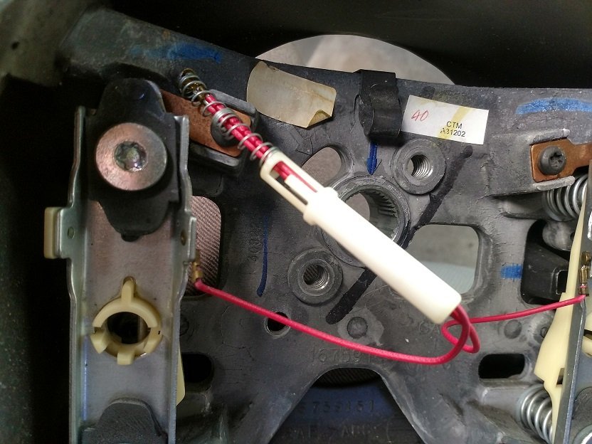

Anyone know where I can get one of these connectors? It's for the horn wire in the steering wheel.
Dorman sells one but it's only good up to 1994. No luck on Parts Geek either.

The little "fingers" that catch the socket are broken off. Nothing to keep in in contact with the clockspring.
I did find this in the Dorman catalog...
https://www.dormanproducts.com/p-77709-924-089.aspx?origin=keyword
It's hard to search for something if you dont know what to call it. Should fix me right up.

FWIW that's not a fuse socket. It provides the connection between the airbag body (which obviously serves as the horn "button") and the wiring to the horn.
It is spring-loaded so there's contact as you turn the wheel.
ETA: Replaced the part today. Fit fine, horn works but I wont know if I actually fixed the problem until I can take it out for a drive. The horn was honking occasionally when I turned the wheel to full lock. I know that usually means the clockspring is bad but the broken wire connector had to be fixed anyway.

That Dorman part in my post from March 7 fixed the horn. It wasn't the clock spring.
