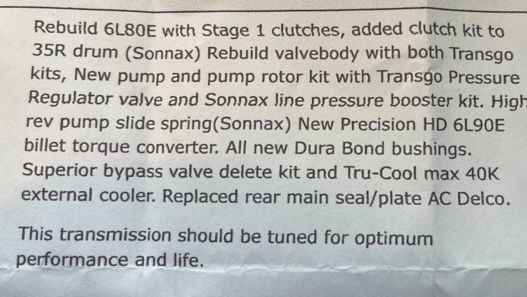

I found a shop in Garland that is going to fix and update all of the weak points.
Price point was very fair. Imo.
im hoping it’s as good as the price. With the extended mileage on this truck, I’d get nothing for trade in so I’ll fix it and keep driving or make as an extra vehicle.  It’s still in great shape as it’s always been a highway vehicle. Waco to DFW, Houston, Austin and San Antonio.
I‘ll share where once I get It back.

Note all the parts in the sonnax zip kit I listed.
It is just a piss poor design. As all other consumable good these days it was built with low cost in mind. Straight bull. At one point you could buy directly from sonnax. There were/ are more parts that are to be considered upgrades that correct the bs in these gm trans.
