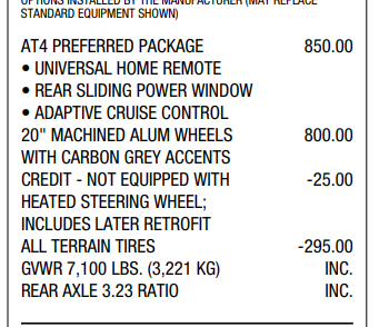

Figured it out.  If you get the 18" wheels they come with MT tires and no other options.  If you get the 20's w/AT tires that's the smoking gun.  Can't believe there is that big of a change in mileage.  Could swore I'd found some with the higher rating w/18's but apparently not.
275/65/18 vs 275/60/20... one is almost a 33 tire while the other one is 32 inch tire. still crazy difference.  Maybe this is why GM didn't put something bigger then 33s on the new ZR2 . ( MPG standards ?)
The rolling resistance on the duratracs is really high.  The rolling resistance is almost 40% higher than the 20" tire.  The lift on the AT4 also hurts aero performance.

Yeah, clearly the tires are huge factor.  I changed my order to the 20's with the AT option.  I just hope it comes with the Bridgestones that were on my '21.  The lift doesn't seem to make a difference, the AT4 with AT tires is rated the exact same as the Denali and SLT with identical drivetrains but could fall within that grouping you spoke of.  I don't see why the lift would make a difference unless it severely altered the aerodynamics

The magic is the AT vs MT tires.  On the AT4 the standard 18's only come with MT tires.  The 20's default to MT's but have a AT option

2022 (LTD and refresh) AT4 has 18's standard
R3O         Tires, LT275/65R18C blackwall Goodyear Wrangler DuraTrac MT
AT4 has two 20" options"
QAE         Tires, 275/60R20SL all-terrain, blackwall
QFV         Tires, LT265/60R20 blackwall Goodyear Wrangler Territory MT
AT4X only comes on the 18's
