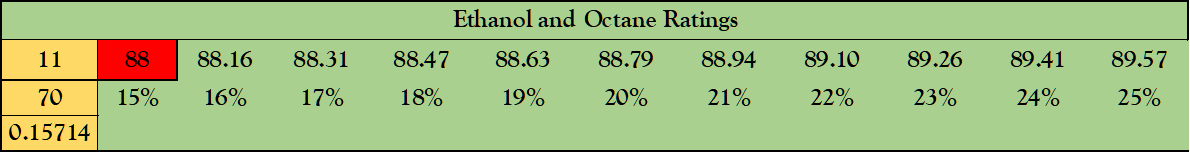

swathdiver Posted July 3, 2022 Posted July 3, 2022 In making my chart, I chose to use Sunoco's octane rating, E15 is 88 octane, E85 is 99 octane which makes it .15714 between each alcohol percent to the next. I could never find the feds standards, they didn't seem to have much consistency and have not looked in about 2 years since I went with my own chart using Sunoco's data. This is look a part of the chart: 2
