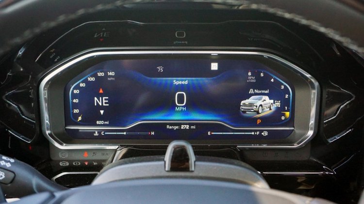

Can anyone confirm rather this is the part number for the new digital cluster
F Cluster - GM (84365019)
None of the Online Chevy Parts websites have a photo of it.
Looking to swap out the custom cluster and leather wheel

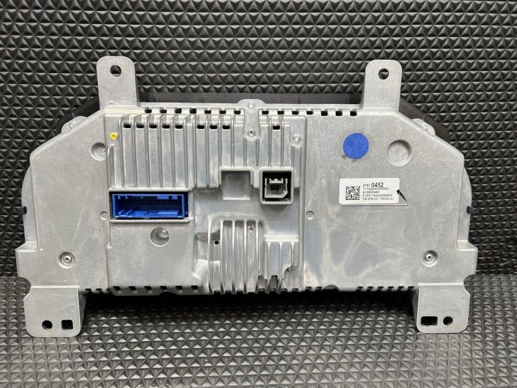

So I found a new cluster on Ebay for a decent price. But before I order I will contact WhiteAutoAndMedia to see if they will be able to program it. Connectors look exactly the same so i'm assuming it just needs to be programed to my VIN. I guess i'll be the guinea pig lol.
All I can say is good luck.  The refresh trucks are on Global B electrical architecture (formally known as GM VIP).  WAMS has no support for this yet.  Its a whole new ball game with this change.

Your Custom has the same programming architecture as the pre-refresh trucks (same dash, same programming). The digital cluster from the refreshed trucks will not work.
