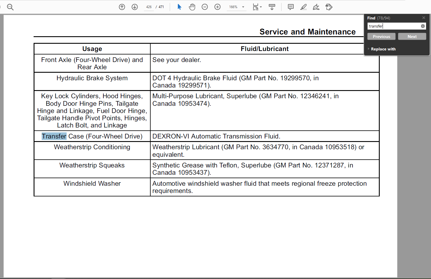

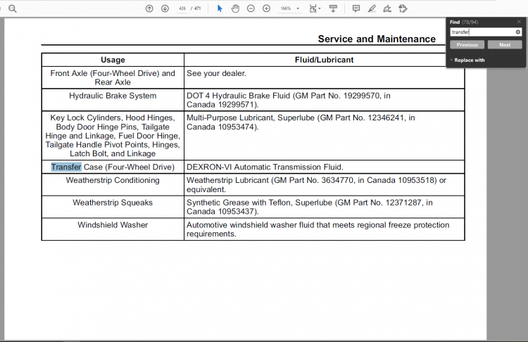

Interesting, mine shows Dexron 6 for the Transf. case and does show "see your dealer" for the front axle (4x4).
13 hours ago, BlancoSilverado said:
This is out of a 2019 (newbody) user manual,
