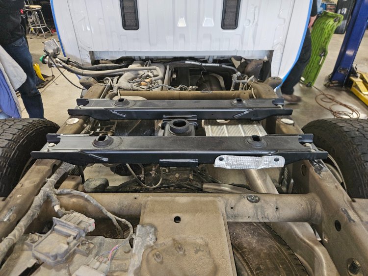

Just had to nip back the heat shield where the two arms bolt up to the rh frame rail

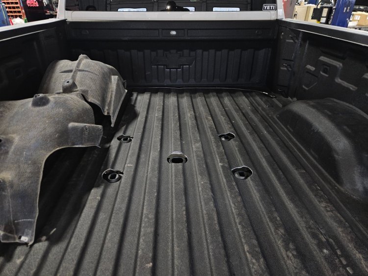

Nice job. How do you figure out where to drill out the bed holes? Dykem on the hitch holes to mark the bottom of the bed?
Straight edge across the bed mount holes, measuring forward, and measuring multiple times.  Hopefuly when i get the bed back on tomorrow its good.  Should be fine as the factory covers are oversize to the hitch.
Did you see a reason why you couldn't have turned it 180° to get it over the axle like a long bed?
I read it was because of a crossmember. I don't see it from your photos.
Then I read it was for turning clearance with the cab.
The 5th wheel system is rear of the axle so it will provide enough clearance between the rear of the cab and the front of the fifth wheel without having to use a slider hitch. Typically anyone that tells people on the RV forums that they still need a slider for this new truck will have one for sale or doesn't know how to set up a hitch.
