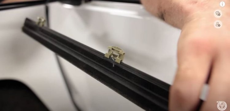

This is the chrome or black trip piece on the outside bottom of the windows.
All of the videos that I found show them being pulled straight up after removing the back screw.  This will break the clips and cause the trim to not lock in securely.  Luckily replacement tabs are cheap and can be found on ebay.
The nub on the clips that holds the strips tight is very, very small.
P/N 11547339 for the clips

Which video on youtube?   This one?
Edited by rav3
Yep, that is one of them.  I used that method and the clips snapped.  I couldn’t figure out what was going at first because the clips looked ‘normal’ but closer inspection revealed the tiny nubs that lock in place were all broken off.

Could you view the video I posted & see if you can see what exactly breaks off & see if it broke off on his?
The nubs that break off are on the other side of the clips in your picture.
Visible in Pic #1 of the ebay listing below.

Got my new clips in, installed them and now the trim is tight like it should be.  Satisfying snaps when I pushed it back into place.
To remove the old clips, use a small flathead to unhook them from the rubber edge and then slide them to the open end and out.  My trim had a crimp that I had to bend out of the way to slide the old clips out.  Used needle nose pliers to open it up and then a small hammer and punch to crimp it back.
The new clips just push into the trim easily at the old locations.
