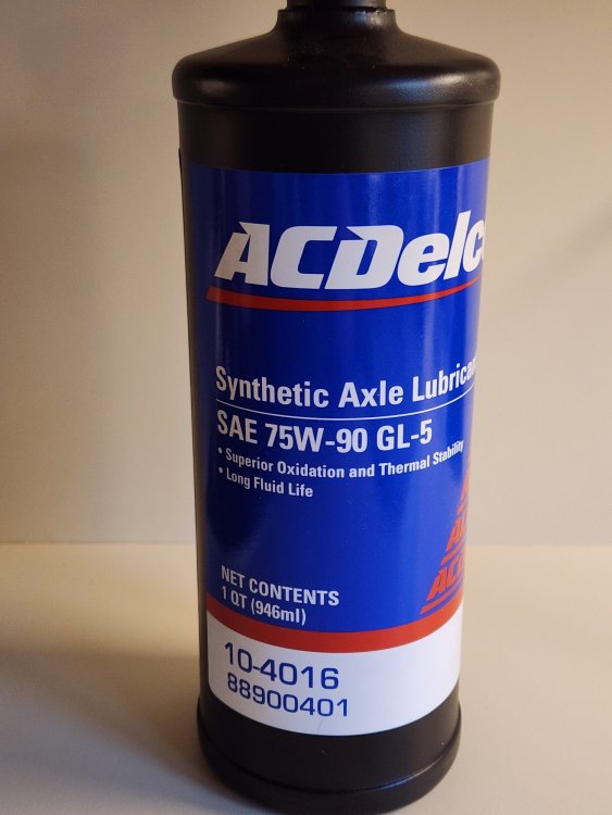

GM dealer parts dept. printed out the attached GM lube document #5258436, for my '24 2500HD (and 3500). Says 75w-90.  He double checked with his service manager, with my question of the "LS" version of 75w-90,
being "LS" for Limited Slip Diff. additive.
Said NO, not needed, just the Synthetic 75w-90.  Makes sense as (@Grumpy Bear) stated the HD axles are "Lockers" not a Limited Slip clutch type.  Also reason on one very  tight 90 deg. corner of my shop stone driveway, it chops up the packed stone at 10 mph.
My 2500HD a Unicorn of sort, as the option "Max Trailer Pkg.", gave a 12 in. rear axle, frame and spring overload pack from a 3500HD. GVW at 11,700.
So I guess the HD Locker Axle is what is called the G-80.
Thanks to (@Grumpy Bear) also for posting the 75w-90 viscosity test chart. Most informing on the brand results.

Looks like that ACdelco didn’t perform very well according to that chart. I went with Amsoil severe gear
