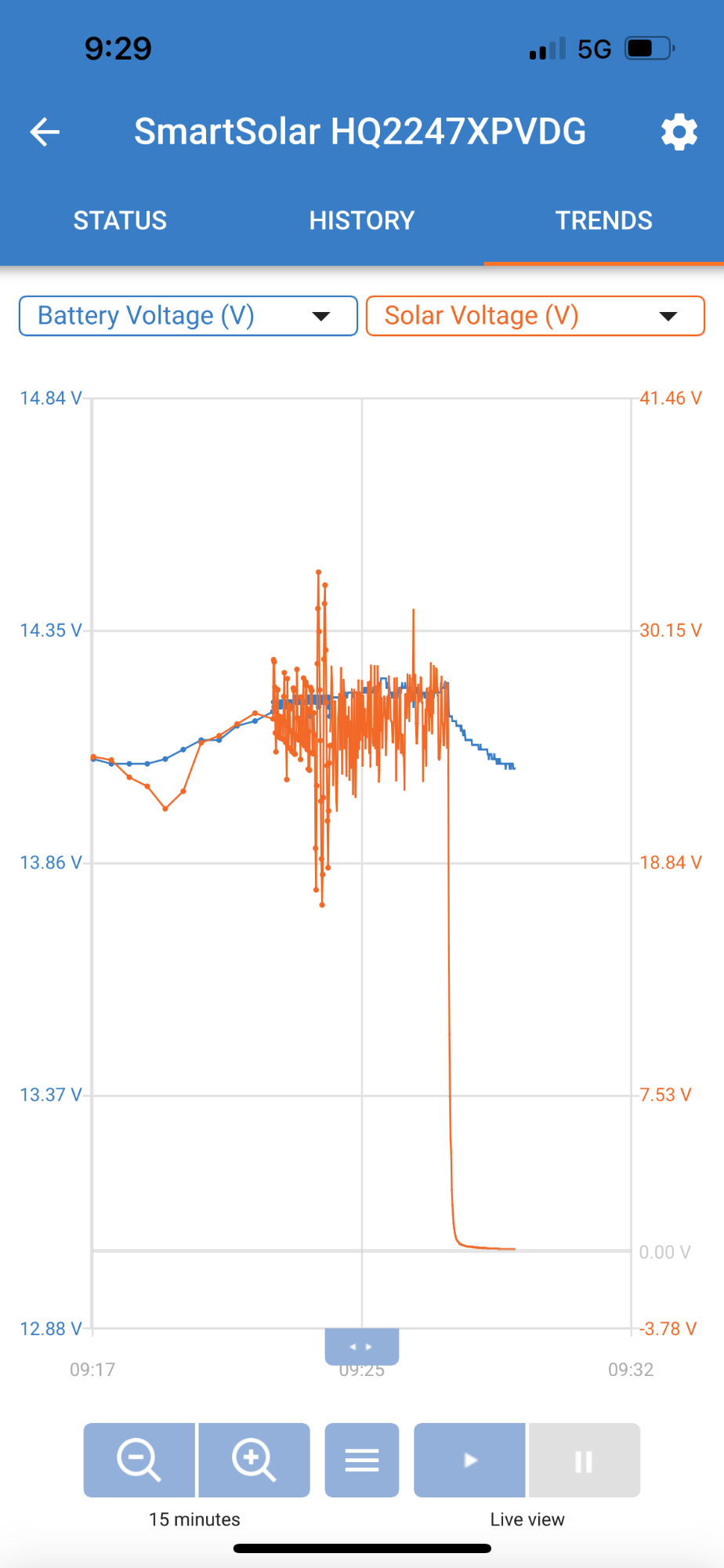

It sounds like there are several issues going on.  I have the "Check Trailer Connection/Check Trailer Brakes" on my 24 3500HD.  It was happening since the first time I hooked up last September but then occurred myriad times on a trip I was just on.  I found this thread and read about the solar battery charger controller thing and figured I'd turn it off at the disconnect the next time it happened.  Sure enough, the batteries charged back up and the messages returned.  I pulled over and turned the charger controller disconnect to off and the issue cleared for the most part.  The part that didn't clear up was the Check Trailer Connection right after start up.  That went away immediately and the trailer brakes worked fine the rest of the trip.
I am going to contact Victron as the SmartSolar Charge Controller doesn't seem to go into float and the battery voltage is above 14v after they are charged fully.  The float voltage is set to 13.80v so I need to have Victron explain to me how to properly set this little gizmo up.  The cool thing about the controller is that it records charging history and I went back a few days to verify the messages were happening after the batteries were fully charged.  Then, when the messages came on the final time, I grabbed this screenshot of the solar voltage and battery voltage to illustrate what is happening.  You can also see where I turned off the controller.

Went camping this week and no more trailer wiring messages after the update, brakes worked fine, and the solar charger went into “float” mode perfectly after the batteries were fully charged.
