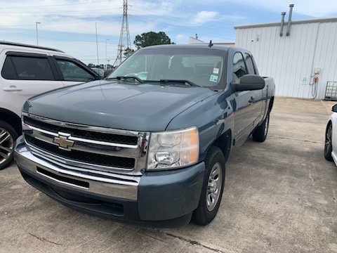

Hello again! After a couple year hiatus, I’m back to GM after purchasing a 2011 Silverado 4.8L V8. It is a one owner, 76k miles, overall great condition. It has the common issues, a crack or two dashboard and it had code P0573 when I bought it which I’ll fix. What I didn’t know until my 2 hour drive back home was an AC issue. After about 30-45 minutes into the drive, the air flow tremendously decreased despite turning the fan on high. I turned it off for about 10 min., turned it back on and worked a bit more and then did t again. When I got home I immediately popped the hood, saw the accumulator frozen over. I haven’t checked pressure, but the compressor does cycle. I also read it could be the evaporator temperature switch. I also found it odd there is no cabin air filter which also makes me wonder if the evaporator is dirty. Any insight would be greatly appreciated.
