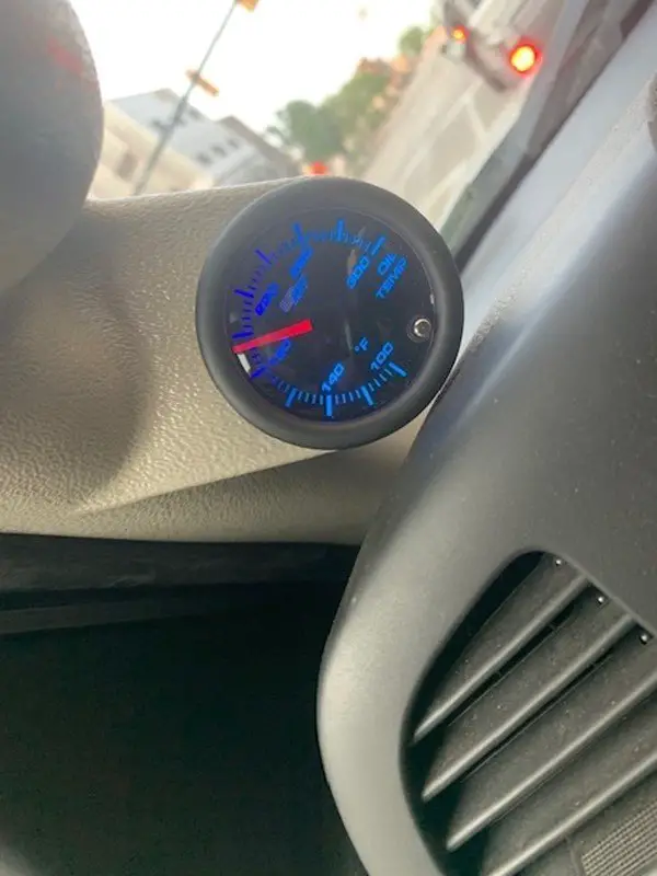

installed my new oil pressure gauge from glowshift - results:
cold start this morning (55* outside)
glow-shift gauge reading: 55 psi
dash gauge reading 45 psi
engine at operating temperature after 20 min drive (60 mph) at stop light
glow-shift gauge reading 32 psi
dash gauge reading 22 psi
glow-shift oil temp reading 187*
10 PSI difference between dash gauge and glow-shift gauge.  makes me wonder a few things:
  • can i lose 10psi from bottom of engine (where the glow-shift adapter is at, at oil filter) to top of engine (where OEM OPSU is located)?  OR
  • is my OEM OPSU Jacked?
  • what gauge would you trust now?

so, took the trailer out for our first trip over the weekend.  Truck drove like a dream.  no issues.  Glow Shift gauge always read 10 PSI higher than stock gauge.  Lowest my pressure ever went per the stock gauge was 20 PSI (at stop lights) and glow shift read 30 psi.
maintained 38 psi (stock) 48 psi (glow shift) while towing at 65mph (2500 rpms +/-)
based on this, i think last year's oil warning situation was a fluke.
